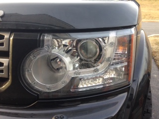

Hopefully halogens (hard to tell from the photo of the headlamp which ones you have... Bi-xenons are an option, depending on your package.)

They are halogens. bulbs were replaced. Weren't that expensive.
