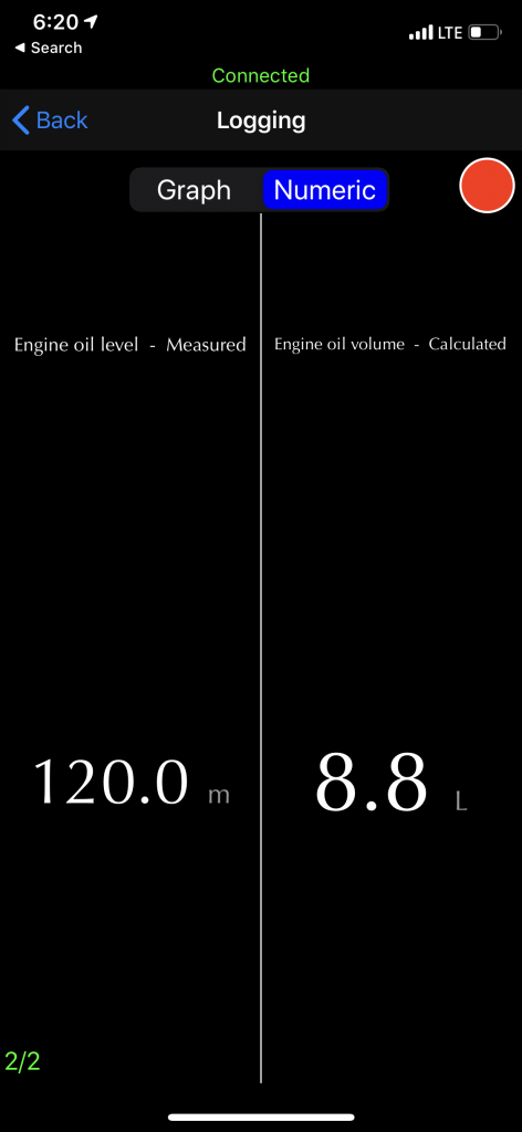

gap iid will give you a live value of calculated volume in liters. It will also give you a measurement that I’m assuming comes from a sensor. See attached. This is from a demo screen (not my actual truck).
Point being, your volumes shouldn’t vary that much in cold weather, but wondering what your sensor registers...if it’s wacky, might be a faulty sensor.
