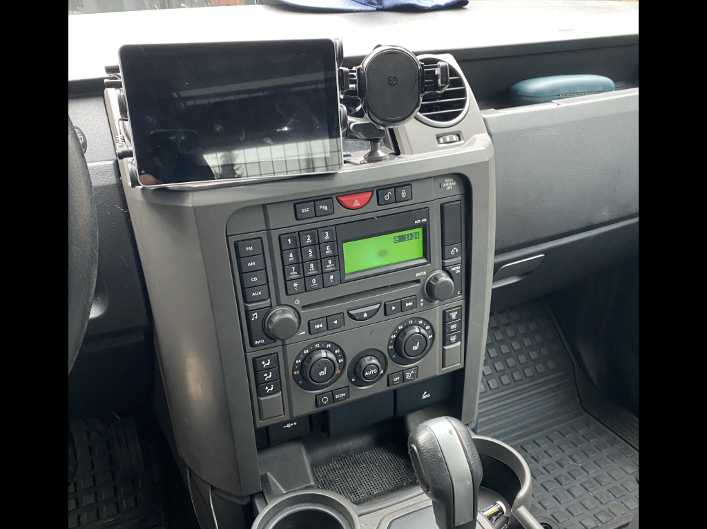

FYI, a different approach. Today I installed a Road Top 7” Touchscreen Monitor with integrated wireless CarPlay, microphone for hands free phone calls, and backup camera. Super easy to install, it just adds to the system you have. You can output audio via integrated FM transmitter or by wire to an AUX input. The Rearview camera works perfectly. Wired or wireless CarPlay works awesome. I paid $329 at Amazon. The unit is showing unavailable but will probably reappear when it restocks. Super pleased so far and this brings together all the features I’ve been seeking for six years!

This looks like a great solution! I've been using an iPad mini 4 connected via a bluetooth into aux input which works flawlessly, but doesn't have Apple CarPlay. I really like the backup camera feature of this as well.

It looks great. Where did you attach the suction cup to support the device?
