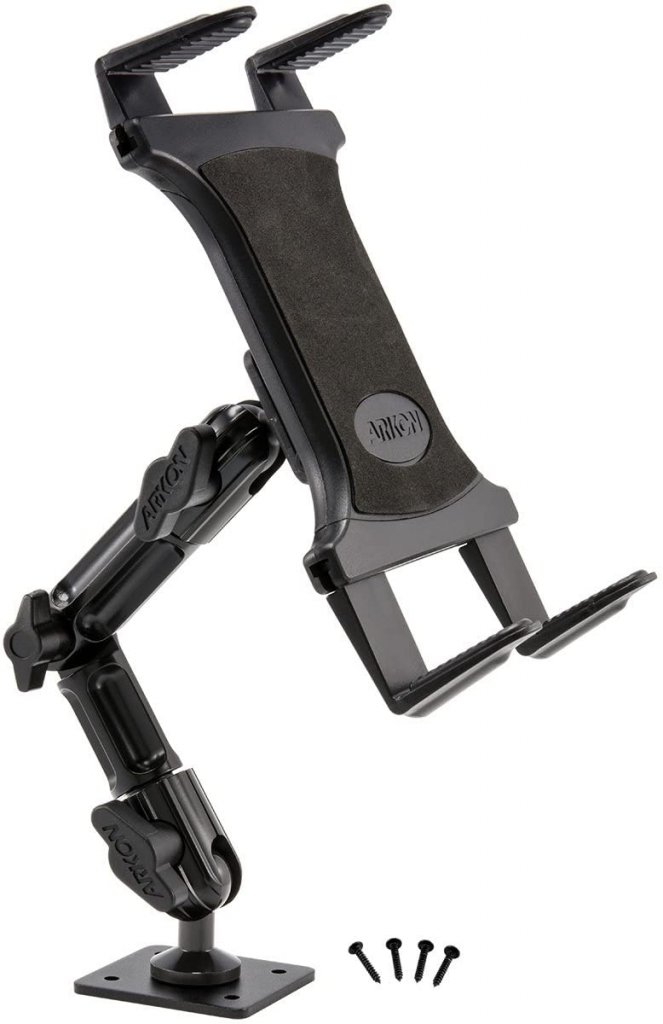

It's unconventional but I decided to temporarily remove the Land Rover factory rubber tray mat and screw down a proper pad mount. I used an Arkon heavy duty drill base mount. If I change my mind, I can fill the two holes and put the rubber tray mat back.

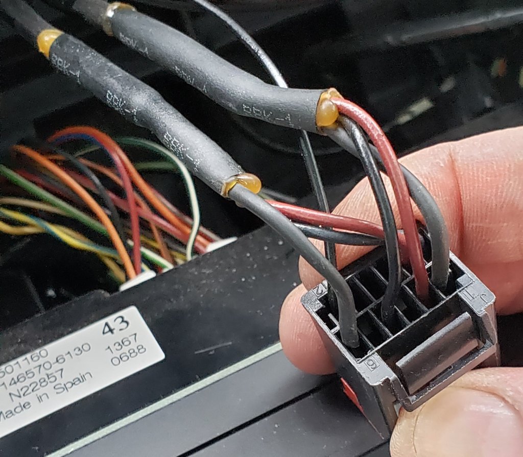

Looking to add a 7" screen where the factory nav usually is in my 2008 LR3 SE. It didn't have factory nav screen. Compared to previous posts, my wiring is a bit different. Can anyone tell me where I should tap the factory plug (what wire or pin location) to get power to the new 7" car play unit? See the attached pic.
Also, can someone confirm which wires are the correct aux wires to tap into? Again, my wiring is a bit different so I don't have blue and red. See the pic of the small plug...I think it would be pin location 7,8 and 6 for ground.

These are the speaker level out from the factory amp. I wired directly from my afternarket HU to an amp, then out from the amp to the speaker level outs. Sounds great.
@Hazer did you ever receive any clarification or response to your question here? I have a 2008 LR3 SE (no NAV) and am looking to do the same as you are here.

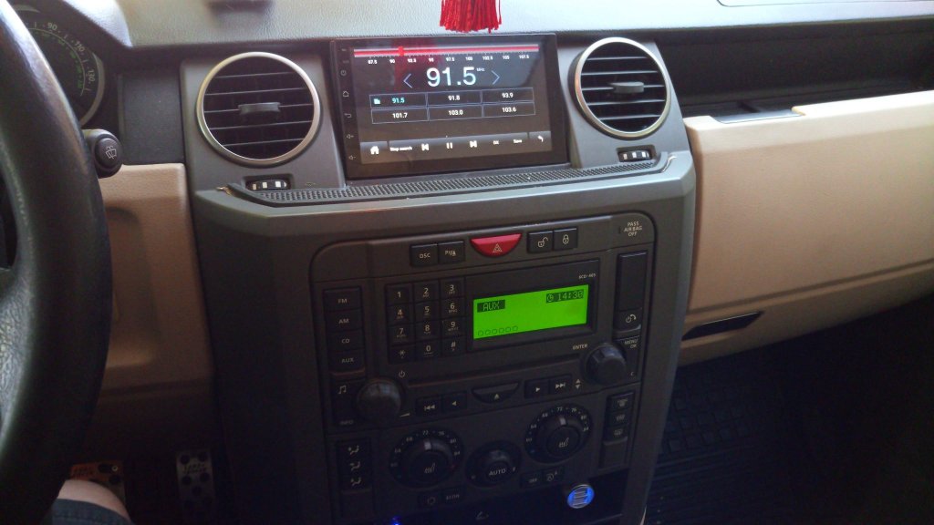

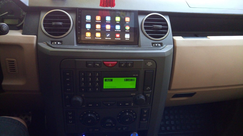

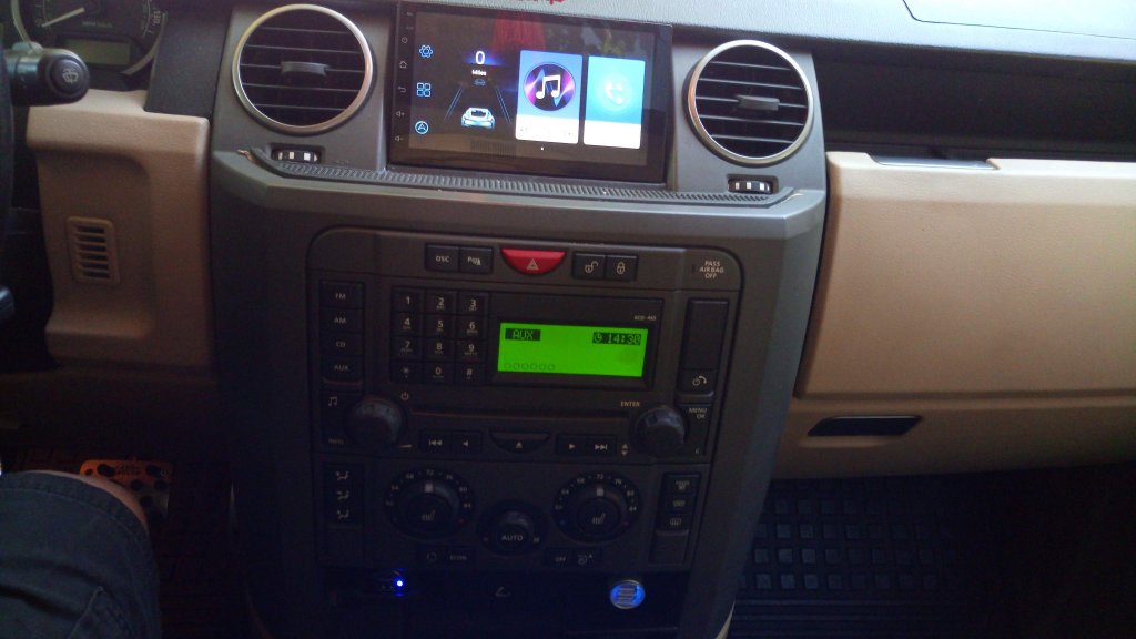

I installed this android unit recently which uses google maps or other gps navigation you can download from google play plus Android auto using the usb connectivity as well as wifi hotspot from my phone. I can play Iheart Radio or other streaming service while connected to hotspot. It also has built in radio but still use factory harman kardon radio. I connected it to the aux input of the gfactory unit so I retain the use of all steering wheel controls, CD changer, etc.
Did this stereo have aux out? I’m trying to connect mine to the existing Bluetooth aux in already installed on my LR3
