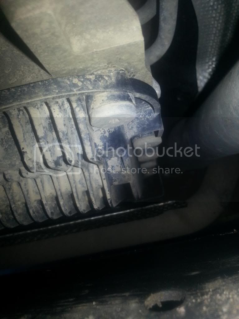

So apparently, I am an idiot. But a fortunate idiot.
The leak is coming from the front passenger corner of the transmission pan. In my blind anger at the leak, and based on the fact that I had no idea of how a structural sump pan was affixed to an engine block, I assumed based on what I was told that the tranny pan was the oil pan. Let this be a lesson: look for yourself, don't trust what other people tell you.
I still think the cause was the same (loose skid plate bolts from oil change place and high speed mountain passes jamming snow everywhere) but lucky for me the solution is much more simple than a total deconstruction of the front of my truck.

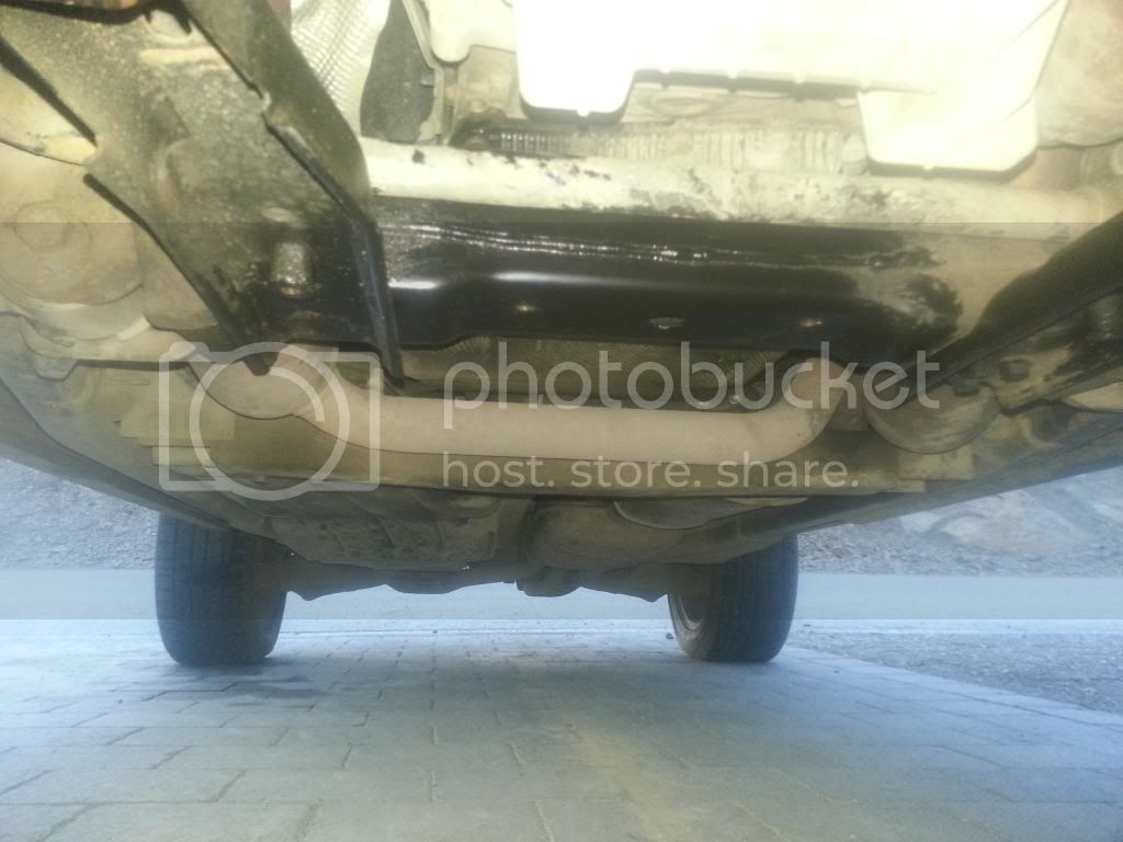

Skidpans off, shiny from the oil. You can just see the wet corner of the tranny pan

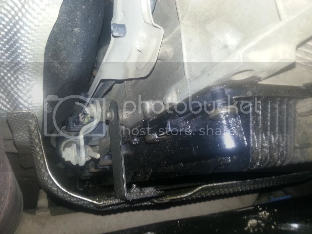

Drivers side looking towards rear of truck. Dry as a bone.

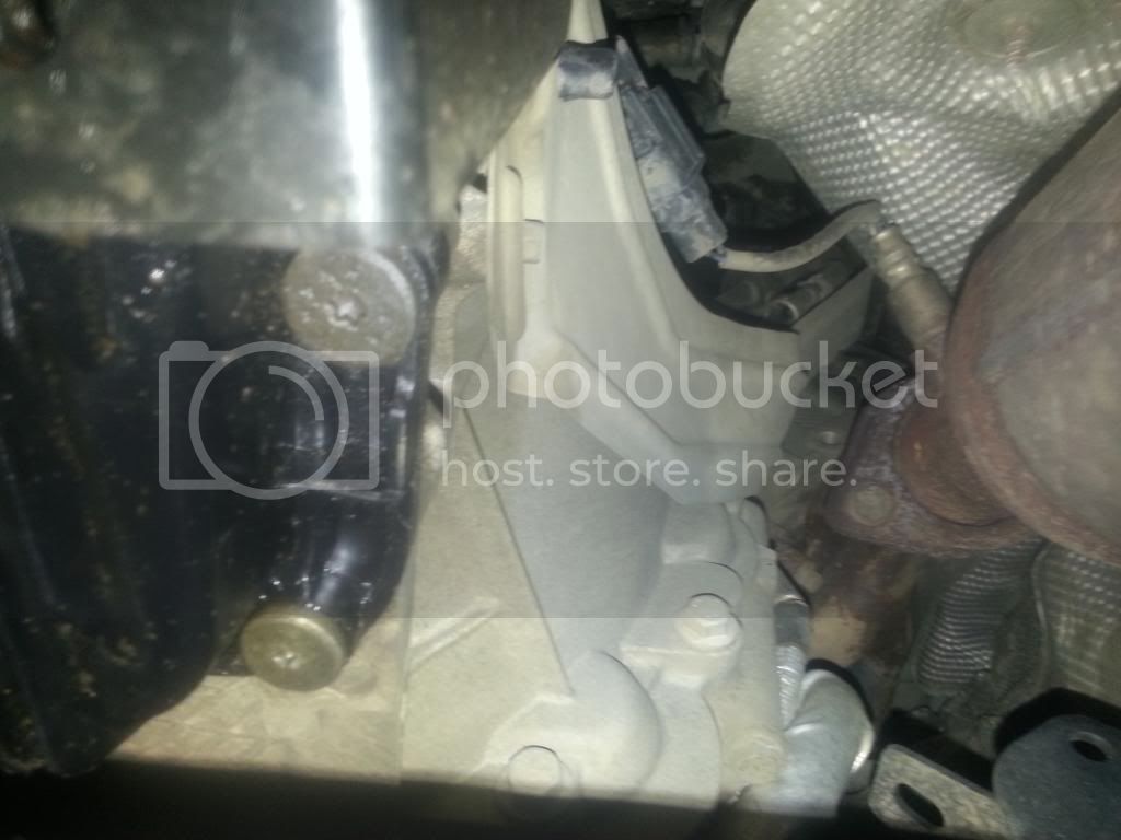

Passenger side, not so dry.
Clearly not coming from anywhere above.
So there we have it, crisis averted. Any ideas of a simple fix I can to to tide me over until parts get here? The torque specs on those little bolts is like 6 lb.ft, I would assume that trying to crank them a little tighter would be a bad idea?

So it is the transmission pan.
Replacing the transmission pan is not exactly simple, but it certainly is doable.
There is a round rubber gasket between the plastic transmission pan the the metal of the transmission body. I would say you can tighten up the Torx bolts but just to spec - that should not hurt anything.
The link has some jpg's that show the bolts bit. Note Ford versions tend to use a metal pan, shorter screws and a normal flat gasket. The LR3 is not normal.
