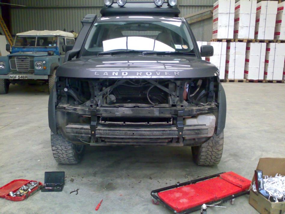

You do not have to remove the body.
Removing the grill and headlights is easy after you have done it a couple of times. You have to learn that anyway in order to replace a front signal light bulb.
The plastic bumper cover has to be removed as well and after you have done it once, it is not too difficult but the first time, it is a fuss.
There are a couple of real small screws kind of holding on the left and right front wheel wheel mouldings that have to be unscrewed to get release of the front bumper cover.
You do not have to remove the body however which is common for routine maintenance on the turbo charged diesel engine 3's.
Have lots of time; do not try to pull too ******* anything; have good lighting, some food and drink, be somewhere warm etc. If not, just leave it till spring, and try to ignore the message.

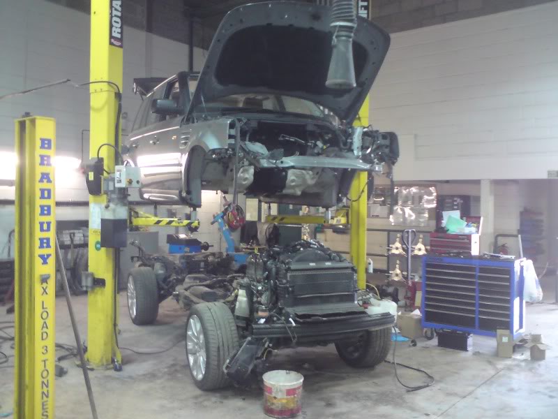

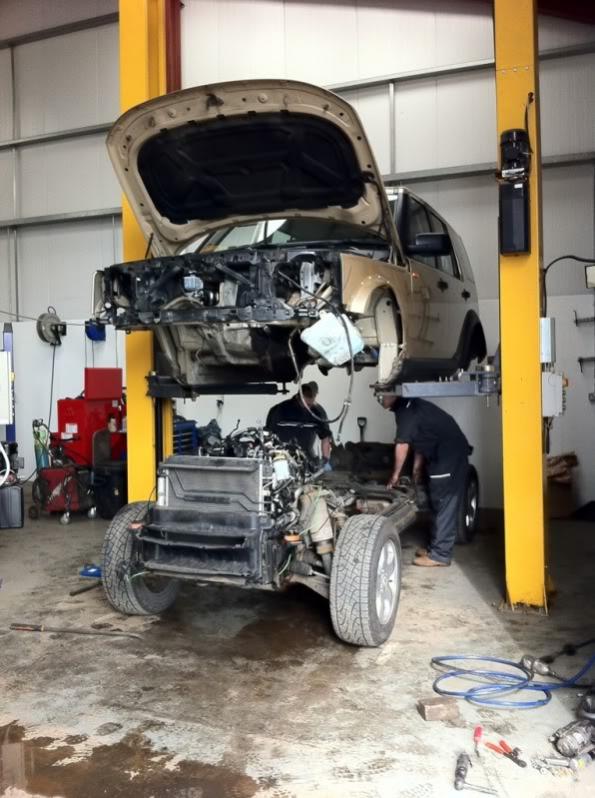

tranny oil change
That is one of the approved procedures re doing a tranny oil change. It is also a good opportunity to get at both differentials and the transfer case for a routine oil change.
What you see is why LR does not change the tranny oil on any leased 3 or 4 under the all inclusive maintenance conditions of the lease agreement; this is the logical consequence of the "life of the vehicle" provisions re tranny oil changes.
Incidentally, the shop guys can get quite proficient at the removal and reinstall. It is not as difficult as it might appear. That is one reason for the big electrical disconnect plugs between the frame wiring and the body wiring; also why the air suspension system is all frame located.
