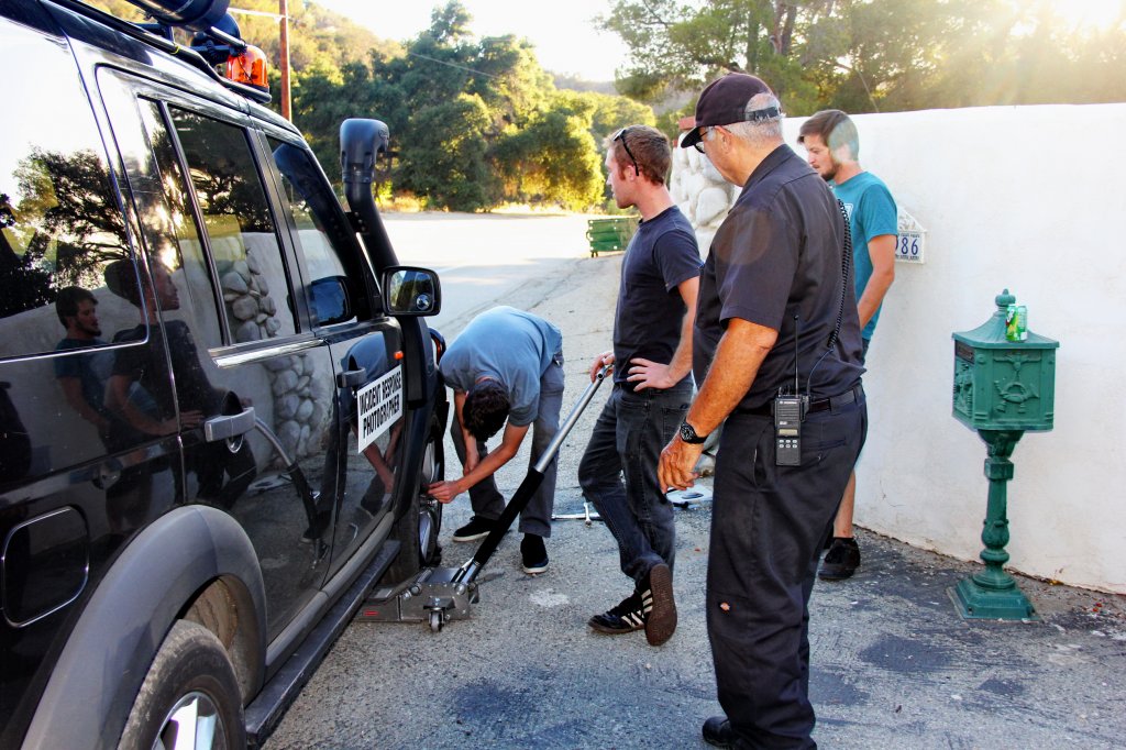

Hi Houm, I'll go by the numbers. I just got back in from a run and I have 181,400 miles on it. And yes I agree, when they try to use a SAE lug wrench with their impact gun it tears them up. And you don't find out until the next time you have to change a tire in the field.
Almost all my flats are cause by rocks cracking and the shards cutting up through the sidewall. Right in the middle of the Sand Canyon fire, I got caught in a rock slide and 15' later, I had two gashed tires. (R-Side) Couldn't get 2 of the lug nuts off so I drove 2 miles on the rims. I found a house that hadn't burned and the owners had chisel to cut the chrome metal off.
Got the wheels changed and back to work. (Their house was protected by a phoschek drop)
