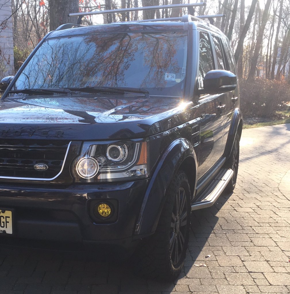

Just thought I'd share my recent fog light swap. I replaced the standard "fog" lights with PIAA LP530 led fog lights and it was almost too easy. I just cut the new fog light wires and soldered on a matching OEM harness which was $6 from Amazon. Otherwise it was a simple plug-and-play with the stock wiring and switch.
I haven't been in any thick fog but based on the color and intensity, they will definitely work better than the stock lights (which I could barely notice).

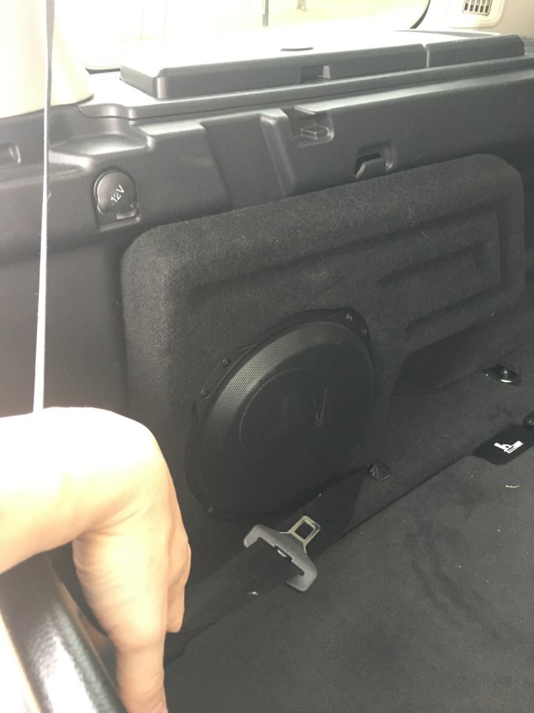

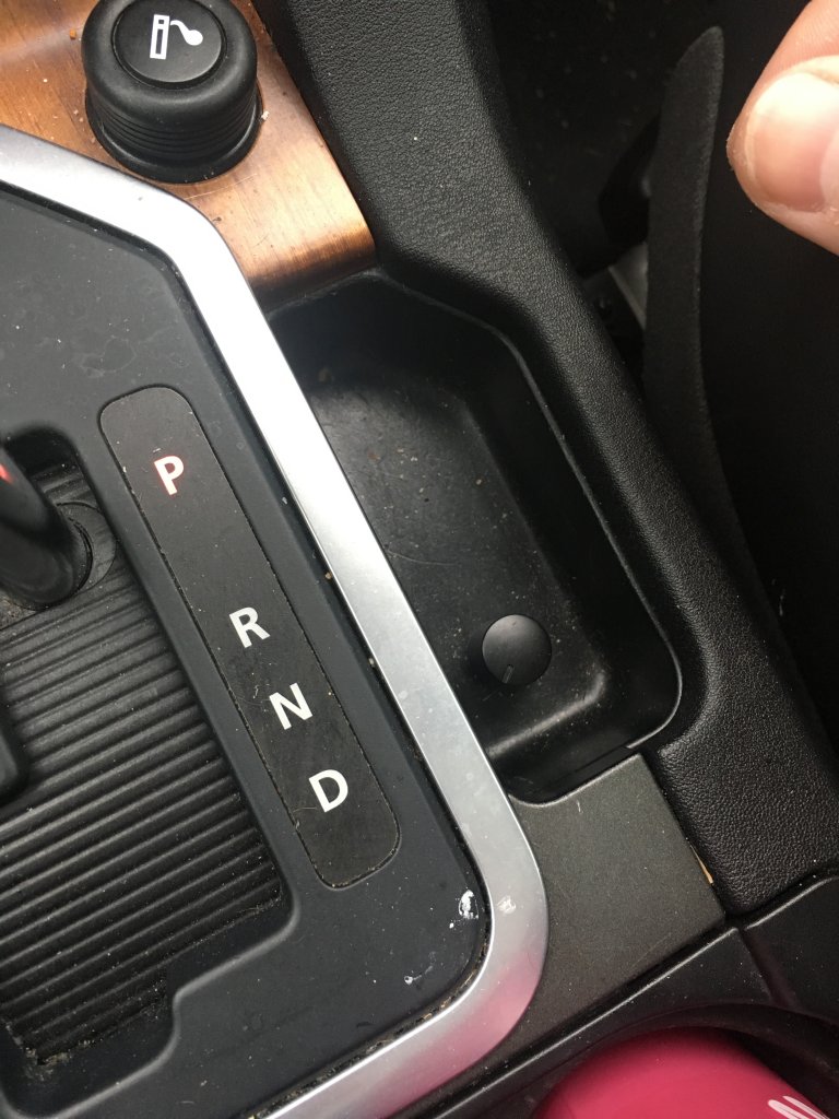

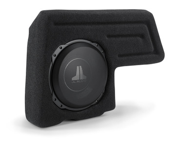

@Surfrider77 A shop in Orlando, Fl called Next Level Customs did the wiring. I normally do the work myself, but remembering the headaches I received from my Lr3 years back I decided to have a "pro" do it. I used their shop specifically because they work on higher end vehicles(Land Rover, Ferrari, Bentley, etc). I picked up the sub and enclosure online and the shop had the amp in stock. They used a converter to wire the turn-on lead and signal together. Amp is mounted flush under the drivers seat out of the way. Base control knob was installed to look almost factory to the right of the shifter. I'll take a few pics when I'm out for lunch.
This is the subwoofer I went with. The factory sub in rear tailgate is still fully functional. No signal or fault issues with the install. My only complaint is that if you wanted to add a rear storage cabinet/tray system the enclosure would get in the way by 2" or so. As far as sound clarity goes I listen to rock mostly so with it being a sealed setup it's perfect for my needs. Not too loud, not too quiet.

Cool! Thanks for the pics! This is the first LR specific enclosure I have seen. Our trucks are pretty damn neglected for anything aftermarket audio. The big issue I know is they use a fiber optic bus from the main dash unit to the factory amp. It makes tapping into signals a nightmare. I have just learned to live with my ****** base stereo package. It was a massive downgrade from my BMW. I try not to think of it too much. :D
