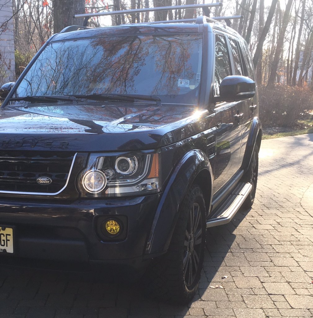

Just thought I'd share my recent fog light swap. I replaced the standard "fog" lights with PIAA LP530 led fog lights and it was almost too easy. I just cut the new fog light wires and soldered on a matching OEM harness which was $6 from Amazon. Otherwise it was a simple plug-and-play with the stock wiring and switch.
I haven't been in any thick fog but based on the color and intensity, they will definitely work better than the stock lights (which I could barely notice).
