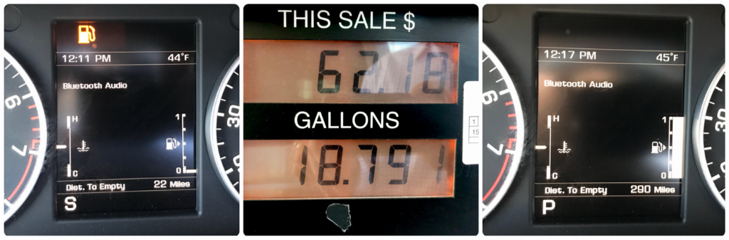

Took this today before and after fillup.
Seems on my truck, it only figures in a 20 gallon tank. Maybe that last 2.8 gallons is the designed in reserve?
That's my guess since the 22 DTE is approximately the distance you could go with the 1.2 gallons left in the tank (if you assumed a 20 gallon tank). Okay... somebody is going to do the math so I might as well. 290/20 = 14.5 mpg. Yup, that's a fair around town estimate for my LR4 to make.
So, in theory, I could go another 40 miles before coming up truly empty. Good to know.
