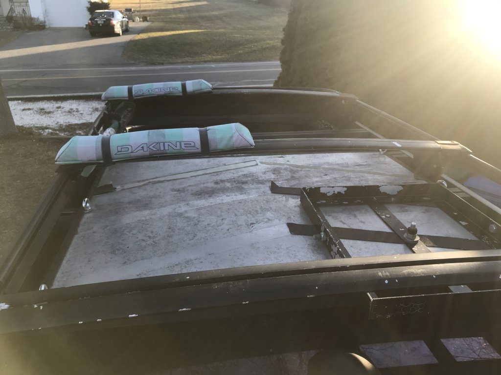

Just got an LR4 with an Expedition rack, which has cross-bars at the base, but my skis are too long to fit in the rack if I mount a traditional ski rack on them. So, I need a better option.
I haven't found anything online to help, so I'm starting this thread where I will share progress as I explore options to add cross-bars to the top of the Expedition rack, so I can mount a proper ski rack.
Suggestions welcome in the meantime!

Update: Yakima timberlime towers connect to the expedition rack side bars really well; from there mounted cross bars. Agreed it's not ideal for mileage, vehicle height or binding grime but it'll let us all get up today at least using mostly equipment I already have.
https://www.rei.com/product/102596/yakima-timberline-towers-set-of-4
Question: if I remove the OEM expedition rack, what's underneath? Just got the Rover so haven't experimented yet.
The dealer can do rails and crossbars for $1300 but that seems like the last resort.

Why do you think there are no rails under the rack? That's what they mount to I think I recall .... ?
Anyway, I did not know non oe were out there but that $1300 is insane. Dealer cross bars are idiotic usually and that $ proves it. The only reason I used Yakima is because they are round cross bars and I needed to deal with a sloping 3 bar mounting plan so I didn't want to also be getting odd contact points on Thule square bars - which I do prefer for some uses.
12 years ago after trying it once in a pinch for exact same reason as you are dealing with, I decided (no offense) that it was pretty much the most ******** thing to do by adding a rack on top of a rack LOL ;) Most people don't truly utilize the racks they have and sorry but the factory one is kinda annoying for almost all things that a rack is supposed to be good for in the first place due to it's weird layout and sort of non-system for mounting things.
I have the extended rails, **** I also just realized I have the short ones too that I'd be willing to sell. Anyway, I use the long because the hannibal is the long version and needs the support out front.
If for some reason there aren't rails under the rack you have, it's an easy install and you'll have a chance to learn how that all goes together if you're into that sort of thing.
