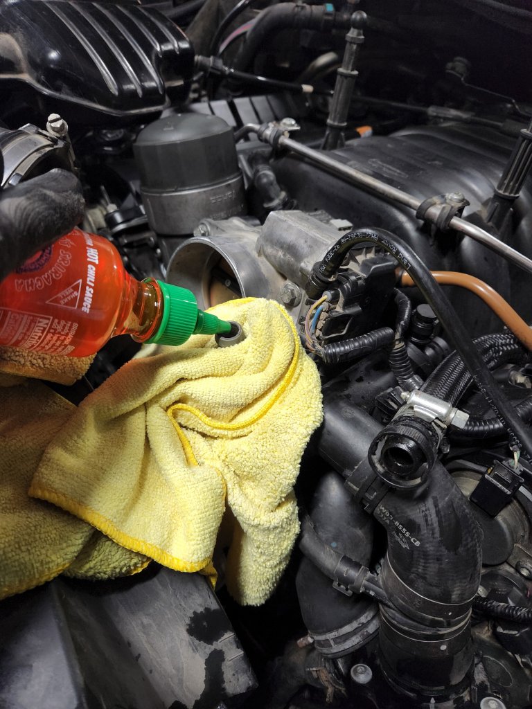

Looks like you dodged a big bullet there. I found that you can get the majority of the air pockets out by removing the bleed screw next to the battery, removing the overflow connector near the throttle body, and the coolant reservoir cap. The coolant will automatically level itself to a certain extent. You'll have a smaller air pocket, but just fill the reservoir to the top and check on it after a day of normal driving.
Here's a pic of the overflow connector on my 5.0 V8. Don't mind the sciracha bottle .20220524_174917.jpg
