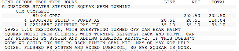

I wound up taking mine to my dealer, in part because I could not find online a definitive way to flush the fluid in an LR4, in part because I wasn't sure what fluid to use, but mostly because I just didn't want to do it myself.
They used what looks like 4 containers of fluid and an additive called "Lubrizol." Here are the lines from the invoice. It was not cheap, but it is done and the sound is gone.
