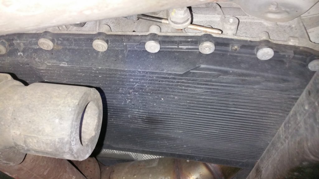

So I poked my head under the truck today and found this:
That's the transmission pan. Isn't there supposed to be a cover over that? The FSM shows one- did all of the LR4s come with these?? I'm semi concerned about it not being there..
It pan job looks like it'll be tight, but do-able. It looks like the pan can come down about 2.5-3 inches in the back... Maybe 1.5 inches in the front..
Mike

My LR4 didn't have a cover either maybe just an LR3 thing like the video showed.
I wouldn't be too concerned yours looks relatively clean.
I'm curious if you can get to all the pan bolts, I didn't look or think about checking until I had exhaust and mount undone already.
