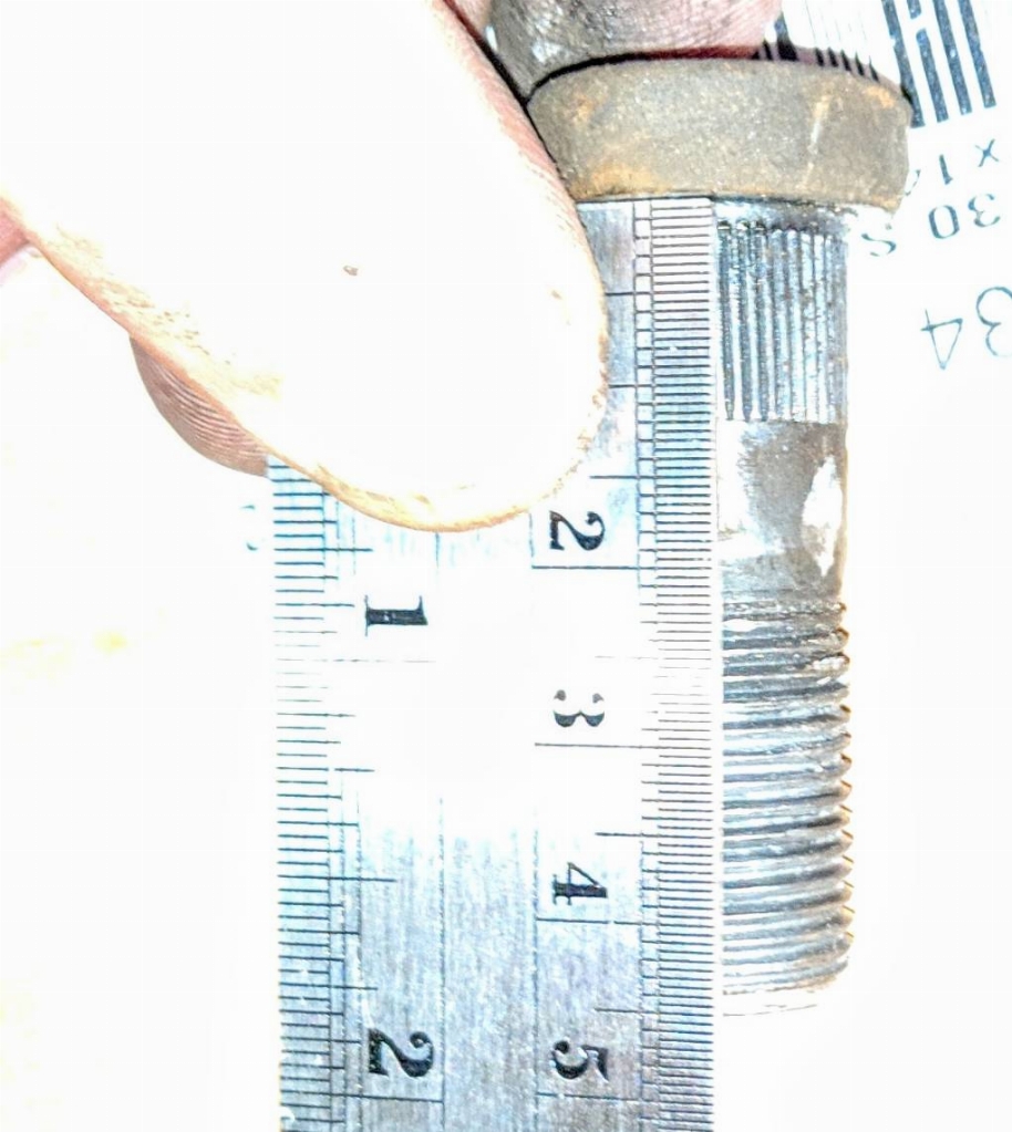

Does anyone have any information on wheel studs? With my new setup I'm inclined to look for extended wheel studs or at least have extra wheel studs out on the trail.
With that said, the only info I have is that you can't buy them. The OEM pitch is M14x1.5, and the lug nuts is a combo conical angle is 60* at the end with a flat washer head. The ONLY replacement is to buy a complete wheel hub for replacing broken studs.
If anyone can give me the details on the studs, like knurl diameter, knurl length, UHL (under head length), overall length, etc... please let me know.

I popped one out to measure last time u had a wheel off.

I don't, sadly I discovered my micrometer to be dead when I tried to measure, which reminds me, I still need to buy a new one. They seem to be of typical diameter for a stud of that thread diameter though.

Backing up 8-9+ months ago I replied on this forum about wheel stud replacements to another LR forum member. I mentioned Dorman, a common manufacture of high quality automotive parts. Your stud replacements check out Dorman;
https://shop.advanceautoparts.com/p/dorman-autograde-m12-150-serrated-wheel-st. Check Advance or by contacting anyone who sells Dorman products.
Dorman has the exact studs for your LR.
My reply also involved wheel spacers, a totally different topic receiving a bad rap causing vibration problems, wheels out of balance. The good and bad about them I found even purchasing a quality spacer branded manufacture from a LR off road parts supplier. Found a cure fixing the vibration problems LR members mentioned with running wheel spacers. I run 30 mm wide wheel spacers now perfectly turbine smooth balance after research plus manufacturing parts correcting the flaws these wheel spacers have created.
Dorman studs are way cheaper than LR's replacement hubs or studs, I'd bet the same if not higher quality studs by LR with Dorman's replacement studs........~~=o&o>......
