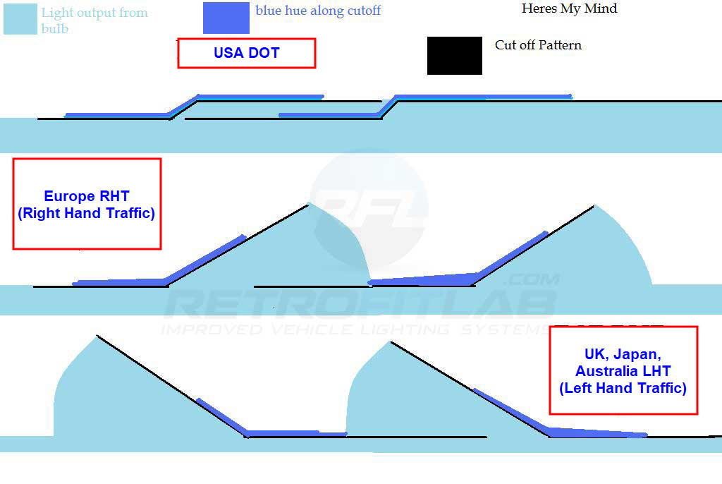

In technical terms, lights are either for right-hand-traffic (RHT, USA/Canada/Europe/etc) or for LHT (UK, Japan, Australia, etc).
Since it's possible to have a right-hand drive vehicle (UK) in a RHT country (USA), it's best to refer to the lights based on the country of use, rather than steering wheel location.
There's a raging storm over on the Mercedes 500E board related to this, as the headlights & lenses are unique to this specific model, and they went NLA a year or two ago. There are a bunch of LHT lights & lenses on the market and many people have a hard time telling them apart from RHT. A couple pairs of "correct" RHT lights sold recently for ~$3k. (!) The LHT stuff is far less valuable.
Why do you care? Because using the opposite beam pattern (i.e., LHT in USA) will shine the lights into the eyes of oncoming drivers, instead of lighting up road signs as they are supposed to.
