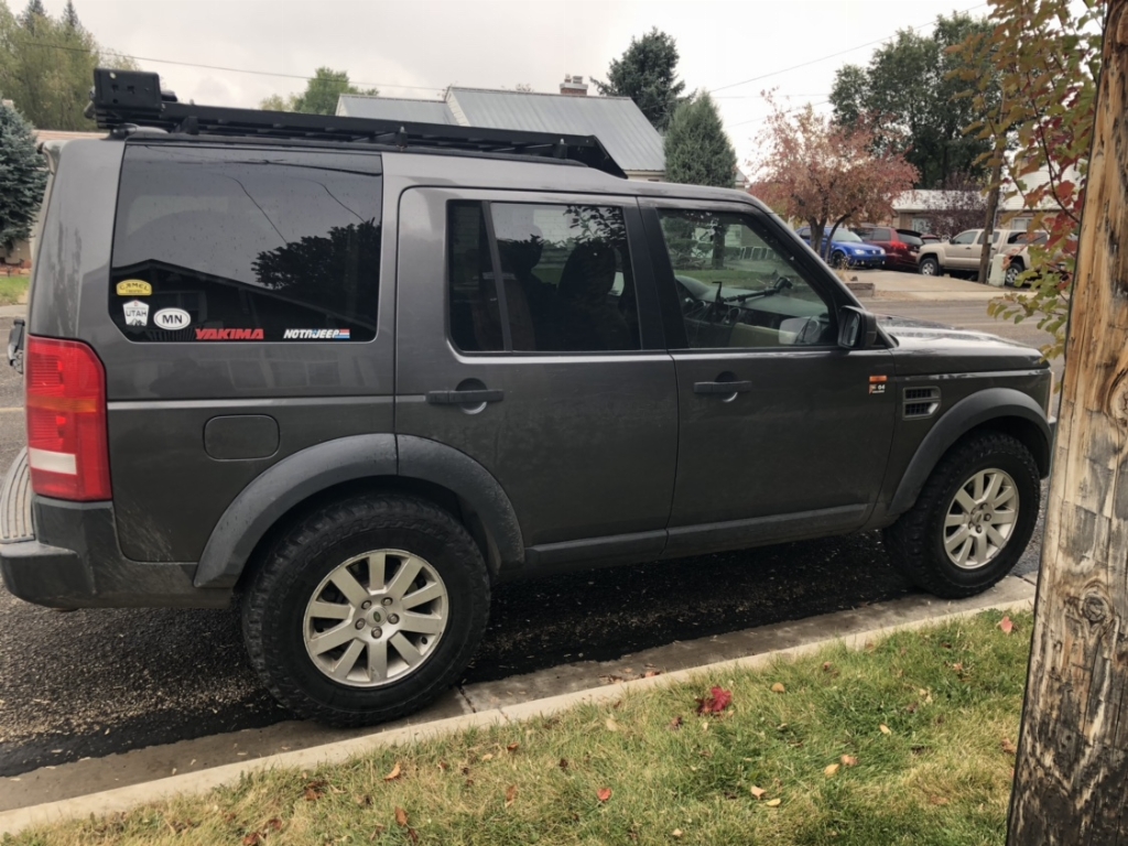

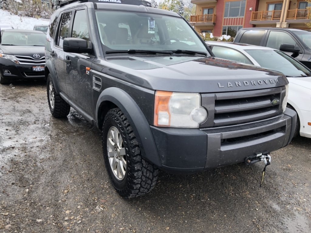

I’ve got the cooper s/t maxx in 265/70/18 which measure (theoretically) 32.6” compared to the nearly identical 32.58” of a 285/65/18
I had minor rubbing backing up at full right lock with about 1” of GapTool lift with BOTH my 265/70/18 s/t maxx AND 275/65/18 Duratracs. I was able to remedy that with a grinder and a flappy disc in no time flat. I did additionally get a rub in the rear wheel wells at the pinch seam when I went to the taller coopers, which I have since flattened.
Houm_WA says those his pros are loud, I would call my s/t maxx noticeable, but far from loud. They are definitely not as aggressive as the pros, but I am very impressed with their performance in dirt, and snow if that matters.
Do you have any pics of the ST Maxx on your rig? One the market for tires and just wanted to see what they look like installed. Can’t seem to find any good pics of them. I’ll be getting the 265/65r18 size. Which according to tiresize.com it runs 31.87” and weighs a hefty 57lbs. Any drop off in mpg?
Honestly I quit checking MPG awhile ago. If it took a hit it was minor. I’ll try to remember to check what the dash says tomorrow.
Thanks for the pics! Great looking rig. I’m pretty much dead set on these tires. I know I’ll take a little hit but it’s not going to affect my decision. Thanks again.
