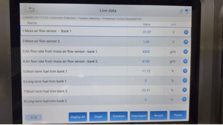

I’m having issues with Bank 1 readings. I switched sensors Bank 1 to 2 and the reading stays the same with Bank 1. The harness has ground and 12v power. The idle is rough but when I unplug the harness and plug it back in, the idle smooths out but the MAF reading stays -31 v. Any ideas what’s up? Thanks.
2012 LR4 146,000 miles.
