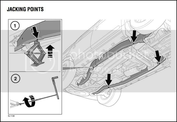

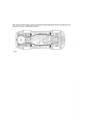

This is for the LR3, but I suppose it applies to the LR4 as well. Sorry for the small pic.
Thanks for posting this.
Its not very clear from the little diagram but at least I'll know where to look :)

There are locating holes for the jack to align with for jacking points. I highly recommend a nice glass of ______, a cigar and a peaceful afternoon to read the owners manual. There is a ton of good information within it regarding nearly every aspect of LR ownership.

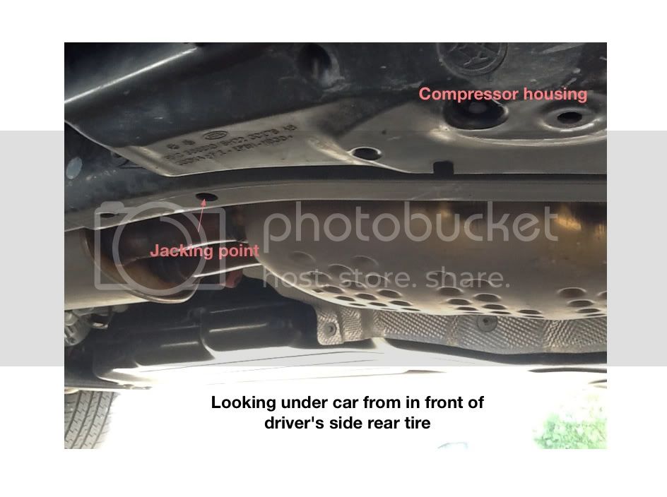

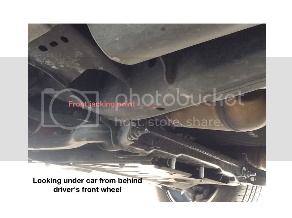

Some real pics to go along with the above images from the manual...
I'm a guy, so, while I did check the manual the first time I had to jack up the car, I saw no need to re-reference it ;)

CaptainSpalding and Dipan
Thanks for posting these. Very helpful !
93
Awesome advice and pictures - thanks, everyone! I printed these pictures and will put them in the tool box I have in my LR4. Just in case!
