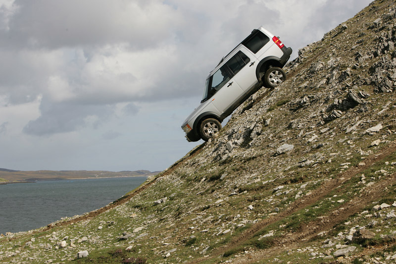

Going up or down 45 is pretty steep:
Houm_WA
Jan 6, 2006
3,948
261
Yeah...you wouldn't wanna get going fast (15 mph+) and then slam the brakes real hard!!!

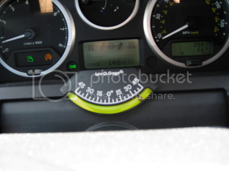

bgsntth
May 10, 2007
201
Could not get the pic cropped -sorry.
Houm_WA
Jan 6, 2006
3,948
261
Boaz...are you turning uphill in that pic?
