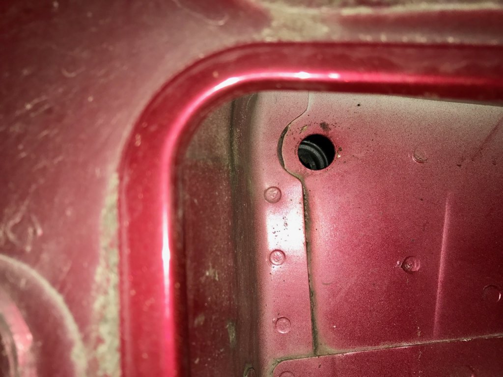

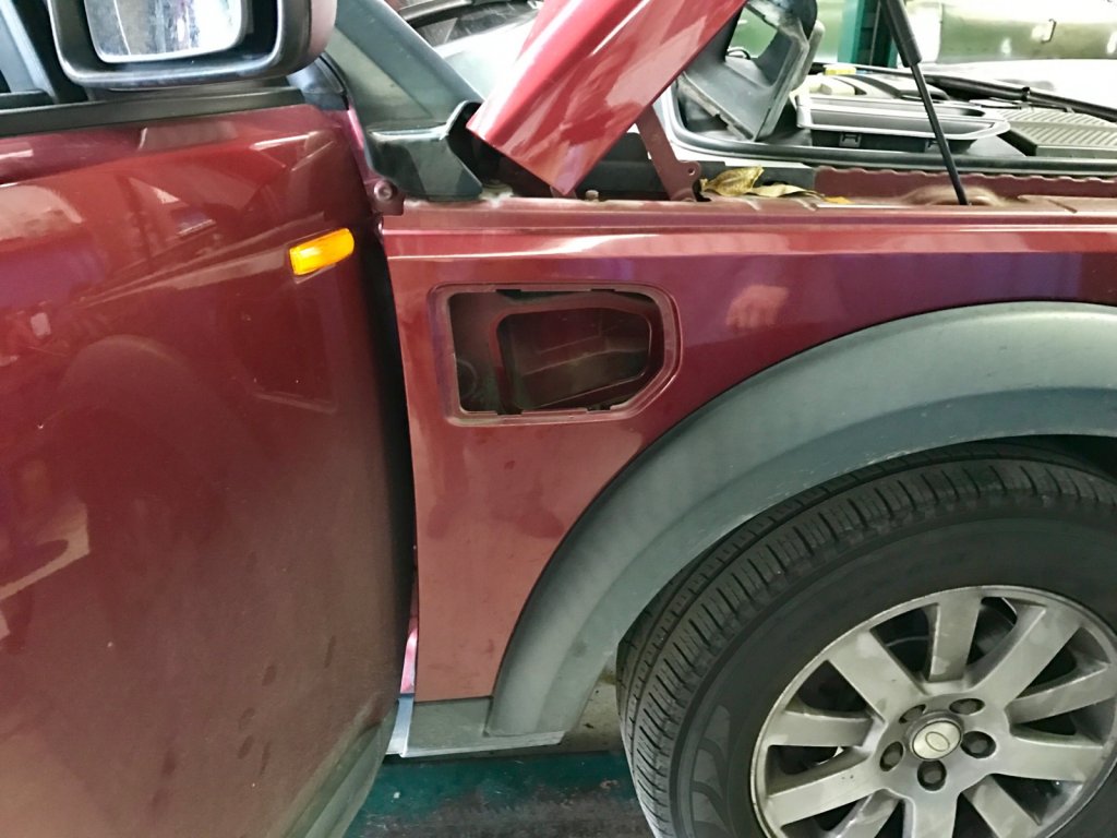

Pay particular attention to the right front floorboard and see if you have wet carpet. Might have to pull up the scuff plate inside that door to check the bundle of wiring harness running down that channel.
Moon roof (sunroof) drain tube ******* are notorious for pulling off inside that vent on the outside fender, letting water draining from the moon roof drain to the inside of the car, right down past the glove box along that right kick panel - where the Body Control Module resides.
