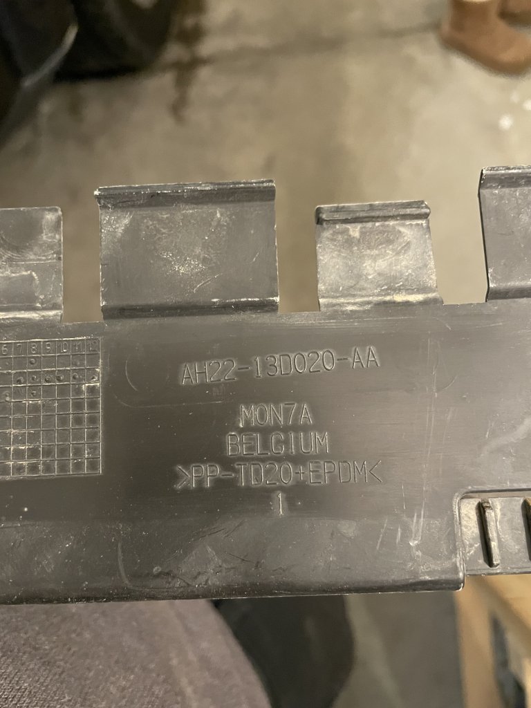

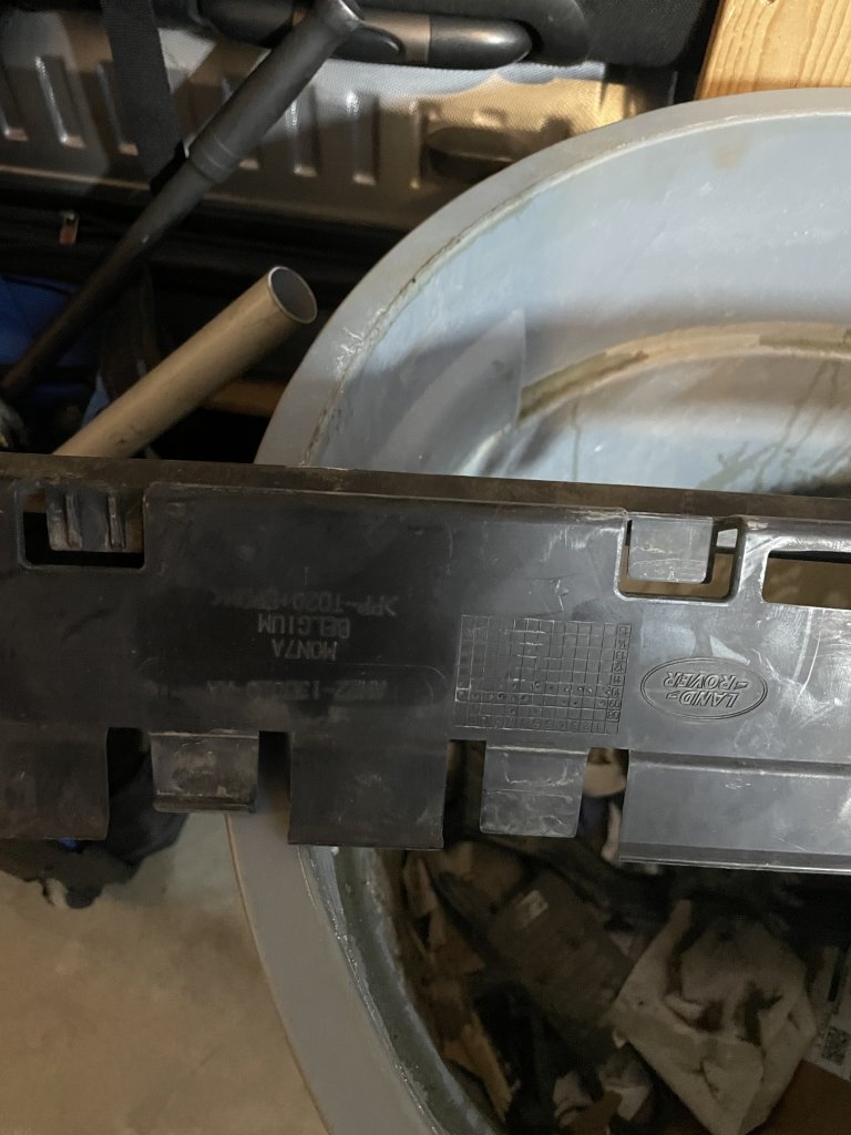

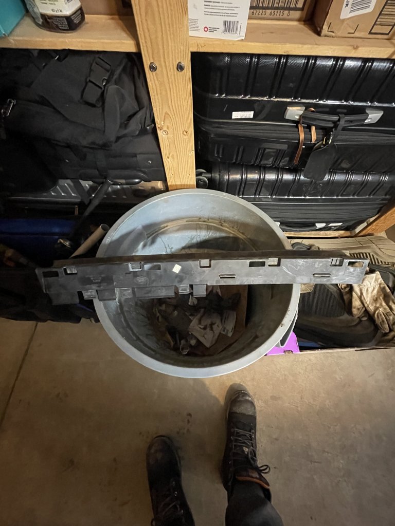

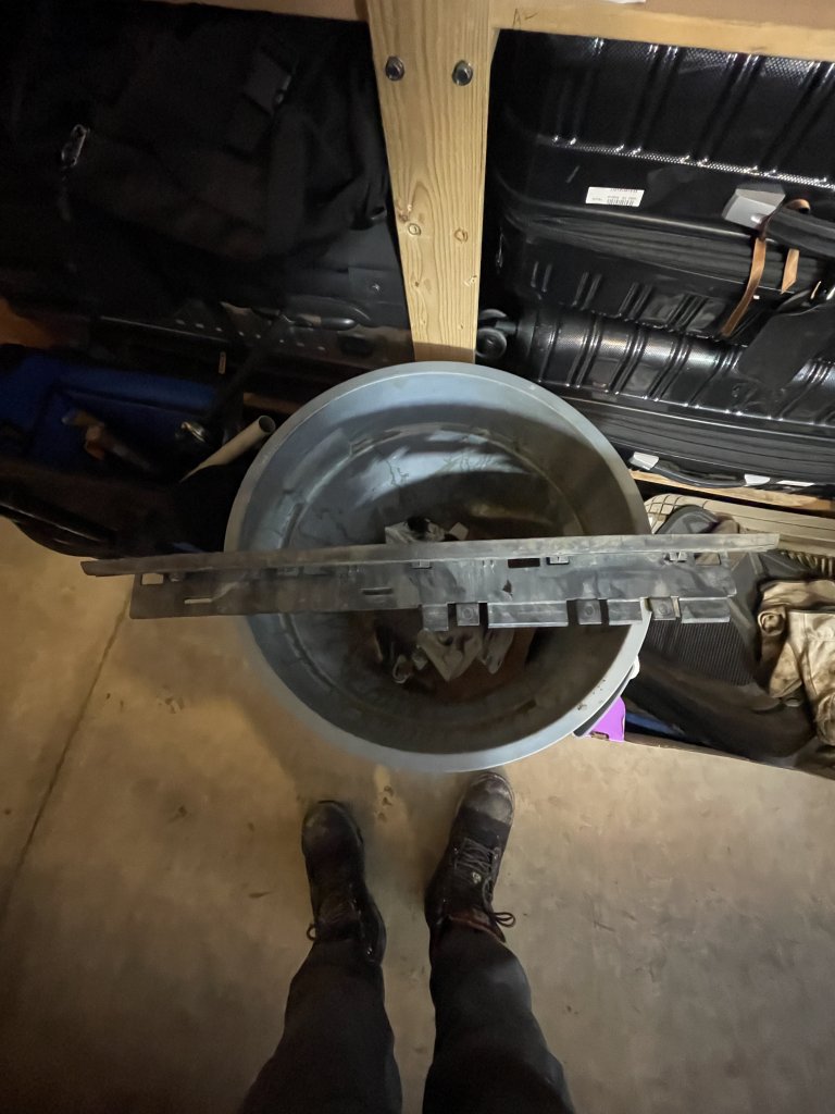

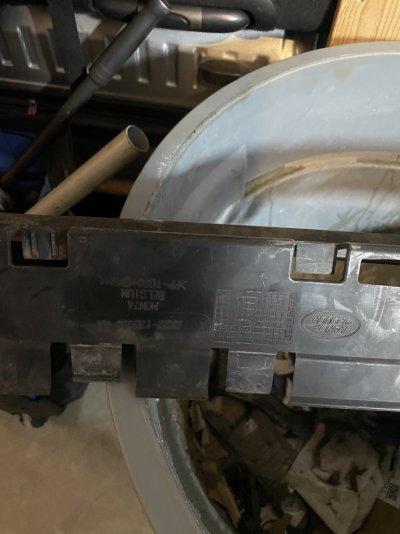

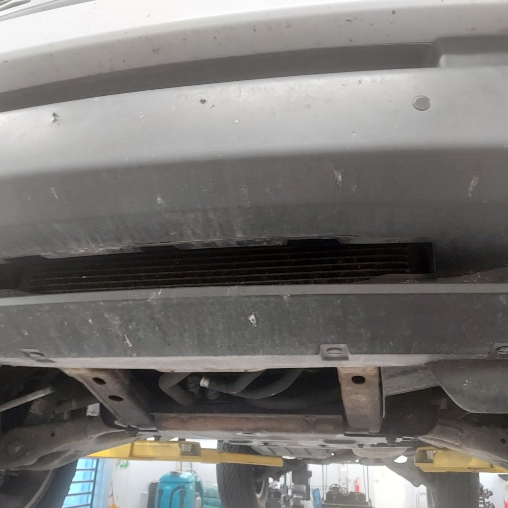

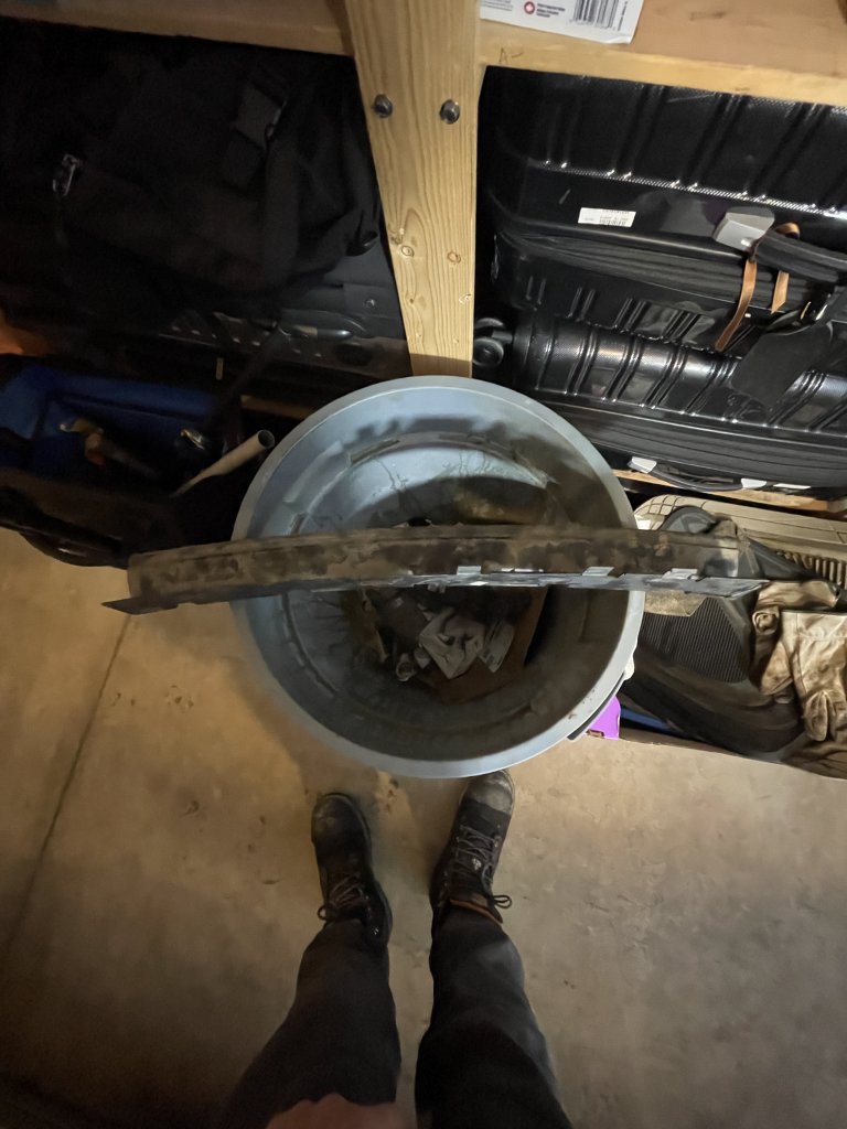

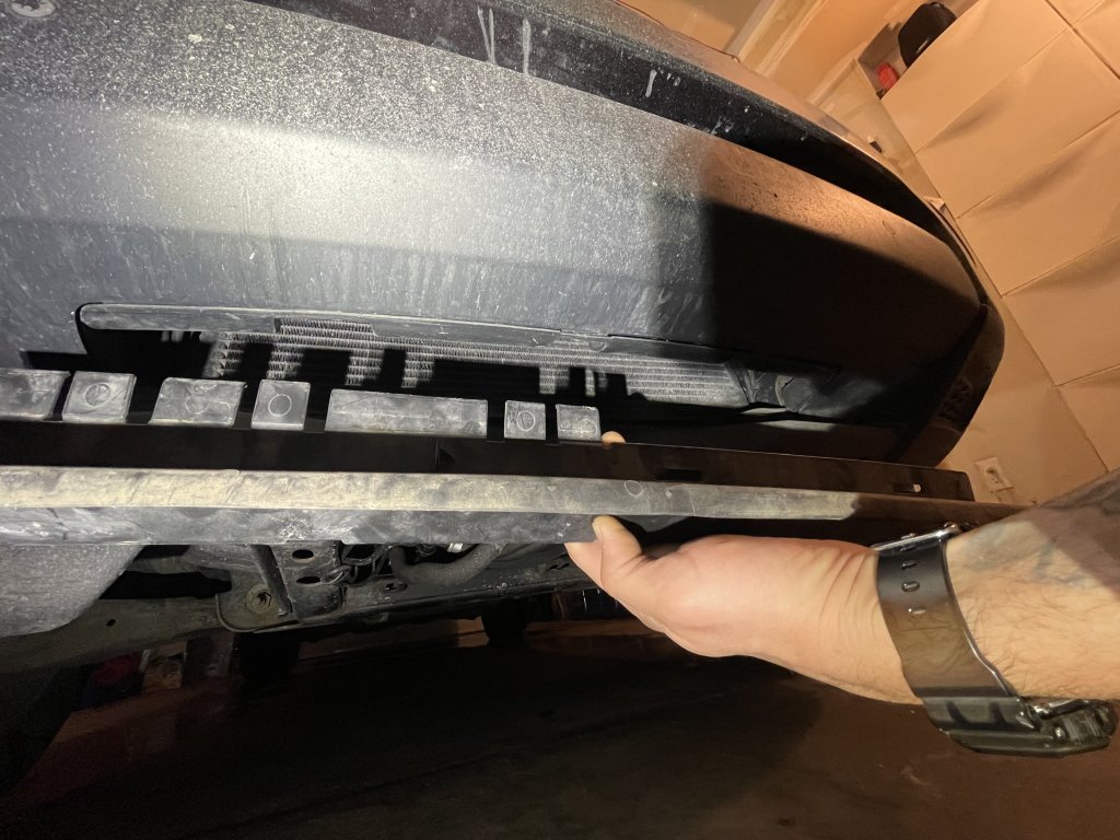

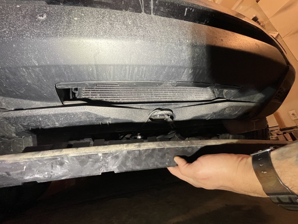

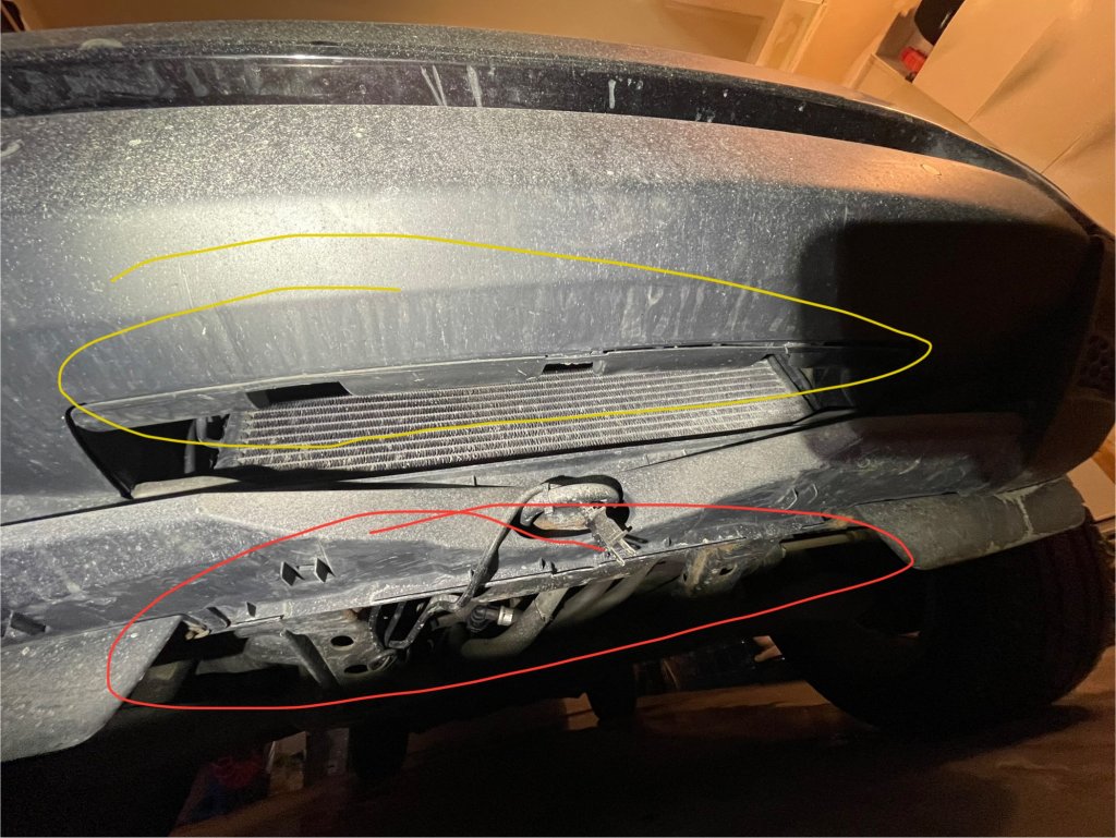

The LR4 I got recently had some hidden damage behind the bumper so I had to replace the crash bar and rad support and bunch of plastic pieces. One of them being the rectangular shaped plastic that redirects the flow to the radiator... but there is this piece that I can't figure out where it stays. The car has been long assembled without it but wouldn't mind putting this back where it belongs ...

That piece fits into the lower front bumper opening.
At the top section of the opening.

There is a part number molded in there somewhere.
Go to an online parts vendor, I use Palm Beach Rover, and enter the part number.
It wil have whatever strange name Rover has given it.
As for me, that's a plasticy bit...
This is the only number I see. I can't find anything....

Does your part look like this?
Nope. Nothing like it. At one end it has a rubber strip... so I assume it is to seal something (air most likely)

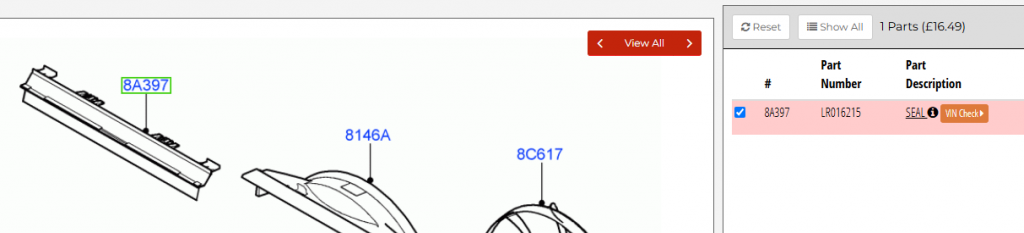

Try this part number: LR016215
Fits on top of main radiator.
