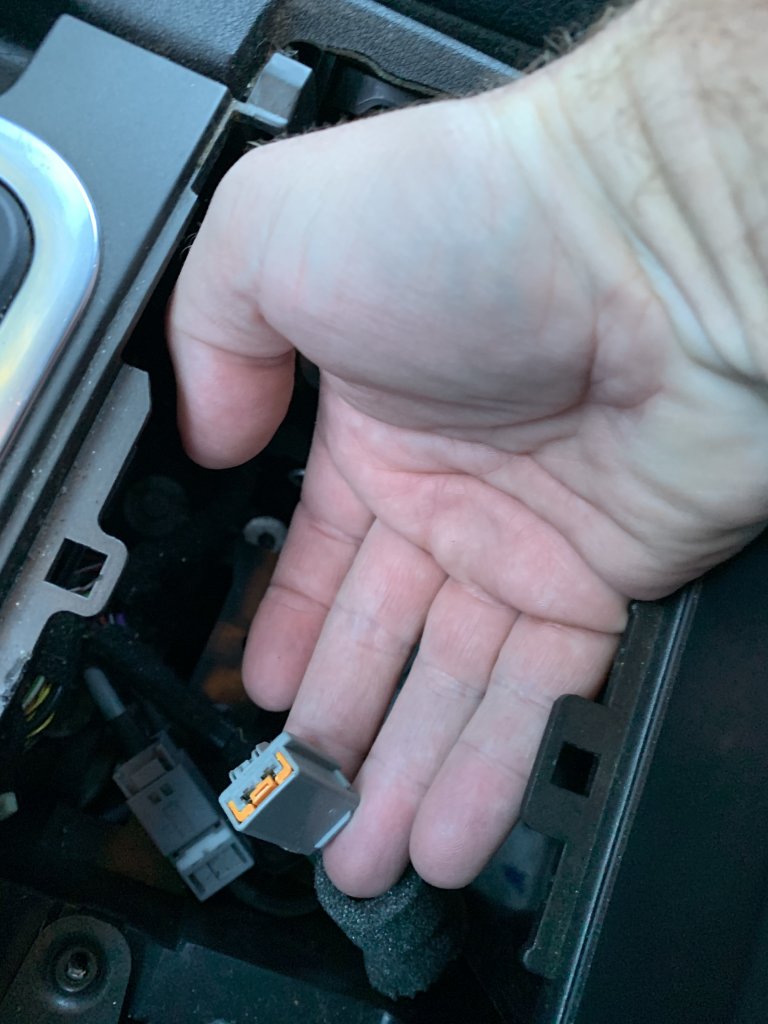

Need help identifying this wire
rchernis
Jan 13, 2021
SF, CA
I removed the center console on my 2013 LR4 as I’m having issues with all the aux power outlets throughout the vehicle. I noticed the a wire not connected. Anyone know that is for? See pic. Thx.

Well if you aren't having any issues I'm assuming it is for an option that your car doesn't have, maybe the console fridge?

Thanks, as I mentioned... all of my aux outlets are not working... fuses look fine. Could this wire be connected to the issue I am having? Thanks for your help.

not sure about that wire.
Junction (fuse) box p101 has a 3p micro relay (r132) and fuse #53 (20a) which control the cigarette lighters/outlets.
i think fuse box P101 is the one under the glove box.

Yeah I got that part, I was meaning that a cable that large unplugged would probably trigger some dash warnings or cause some other side effect rather than just not powering all of your outlets.
If you have checked the fuses Daytona listed about these outlets are known to go bad: https://www.landroverworld.org/threads/lr4-12v-outlet.26012/ can you unplug one and test for power at the connection?
