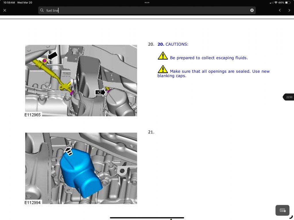

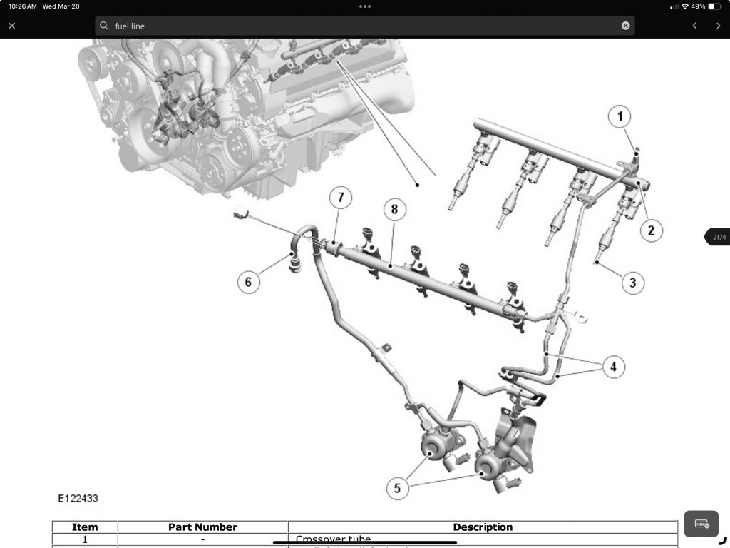

I randomly had a major fuel leak last week. At first I thought it was the HPL (high pressure line) off the fuel pump. After some investigation I found that it was the low pressure line. I have the truck jacked up and the passenger side wheel taken off. I removed all the fender liner and heat shields and can sit it some.
Does anyone have any other pointers to get this thing out easier? Some kind of tutorial?

I seriously just did this not too long ago where the plastic quick disconnect disintegrated. To get access from up top, I removed the battery and box around it. For access underneath, I removed the skid plates (if you have any).
I didn't want to buy a replacement hose #6 in the second picture and have to deal with plastic parts disintegrating again. I ended up using 5/16" ID Gates fuel line, 5/16" brass barb union, and 1/2" spring clamps. I removed the plastic quick disconnect and rubber fuel line from #6 down to the 3 way union near the transmission, you'll see when you pull it out. Then plugged and clamped the barb union into the rubber hose of #6 to the new 5/16 fuel line hose, and the other end of the hose into the 3 way union.
Been running fine for the past couple of months.
