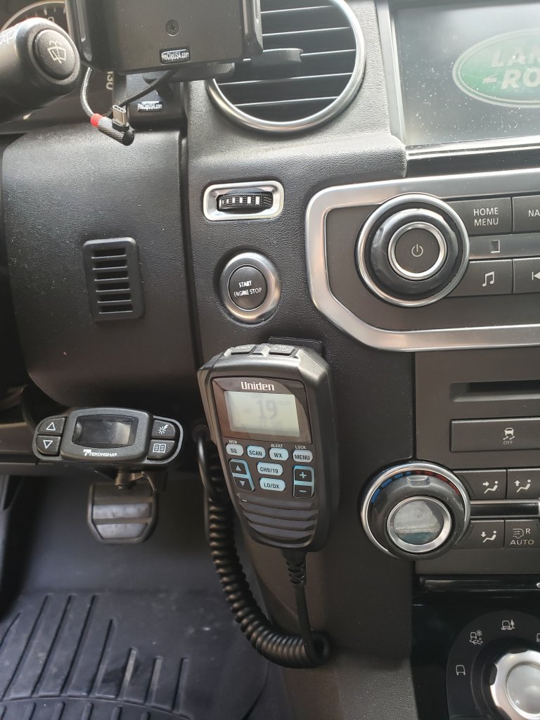

I am using the Bearcat CMX760 in my 4. Happy with it so far.
