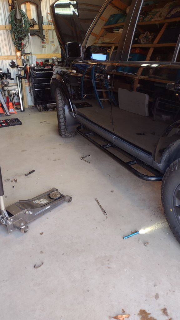

Those are lucky 8's proud rhinos. Easy install.
Regular sockets, impact gun for final tightening, metal trim tool, screwdriver, flashlight and jack used. Oh, and an m8 1.25 tap to chase the threads.
Those are the ones that that cover tank and compressor. They have others like in the video that just protect sill.
They use two body mounts and 6(?) m8 bolts along the outside.
We took our time and bs'd a bunch and it took about 2 hours.
So far I like them, wife will like them more as she has to climb in after the SYA kit and 2"lift.

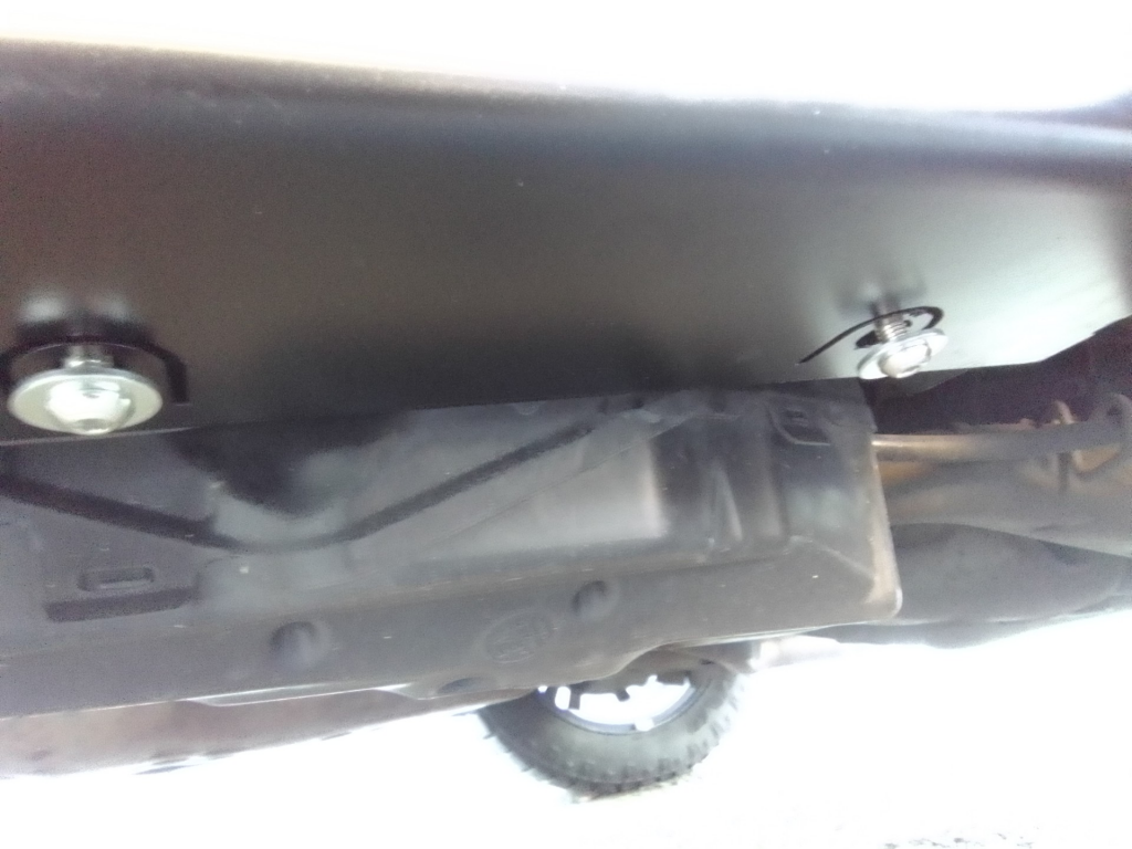

Question about the tap. I was able to get the side bolt in and seat, but the ones underneath consistently stopped about half way in. I contacted Lucky 8 and sent them the pics they requested. Their response was the underneath holes were notorious for rusting. Interesting observation, but not all that helpful. Also, mine were covered with that plastic trim and I used a metal trim tool to pull the plugs. They seemed to come out clean, so I'm not thinking there is any remaining plastic plug inside the holes blocking the bolts from going to the full depth and seating. Any suggestions/solutions would be appreciated.

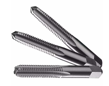

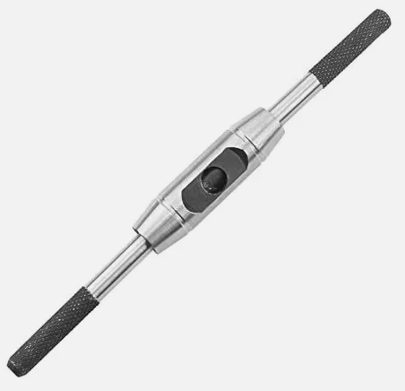

Agreed with ftillier - take the bolt to a local reputable hardware store and ask them to identify the thread on the bolt (M8 or M10 by the look of it - but thread pitch is also important, e.g. M8 x 1.25); you then need a tap and a tap wrench:
you then use this to clean up the threads, screw in half a turn and back out a quarter of a turn until you've gone as far as you can. This will help.
