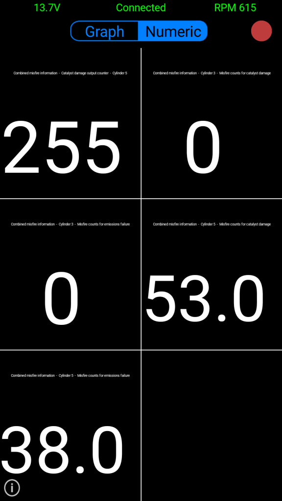

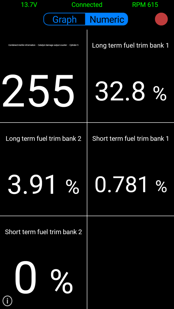

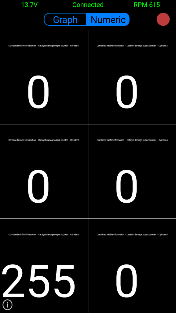

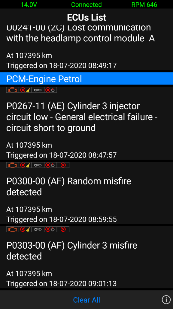

Truck loves the new, OEM coils, but misfire remains. New coils went in the passenger bank, and I played with combinations of the old, oem coils on the driver side bank.
Oh, and the number three injector code returned. I have codes related to the number three cylinder, but with live values, number 5 seems to be the problem..

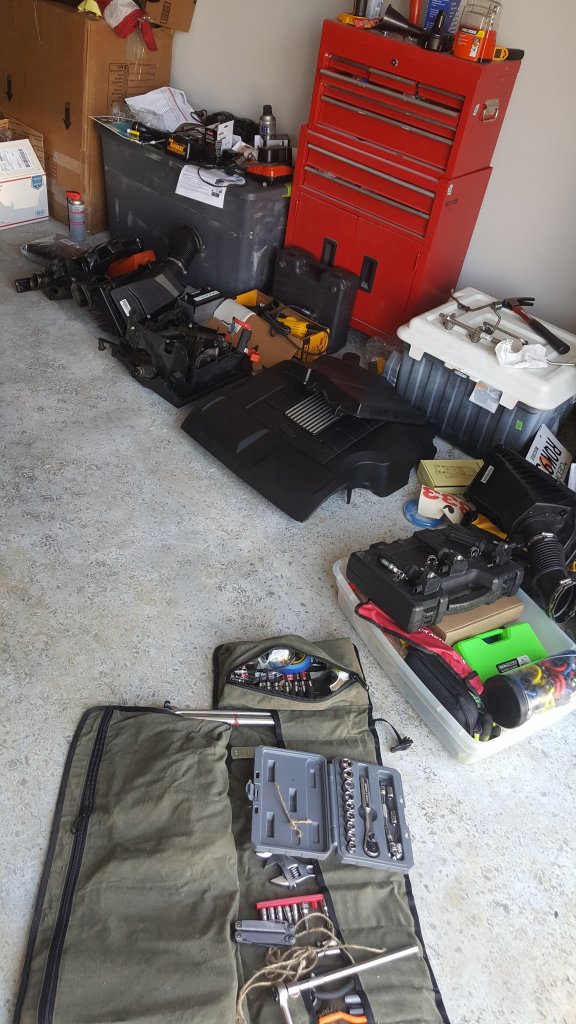

Replaced the passenger side fuel injectors and ignition coils.
Not too bad. Did not have to remove the A.C. lines, but did have to disassemble the driver battery box.
#2 injector needed over 100 hits and some leveraging with a pry bar. #4 and #6 came out with 2-3 pulls.
Everything is back together minus the pieces that need to be off to pull the supercharger. That process will happen over the next couple of days
