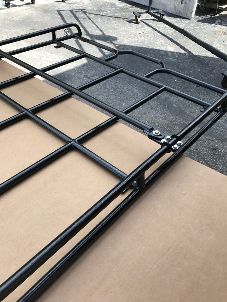

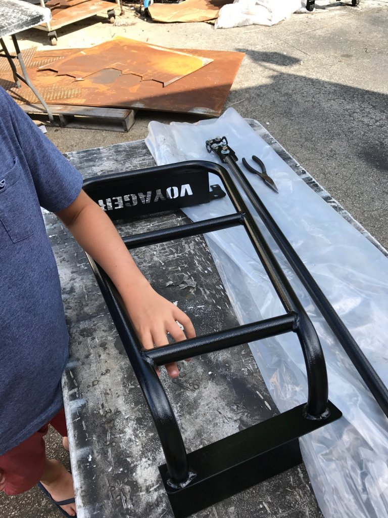

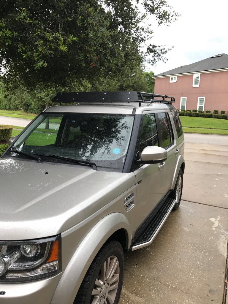

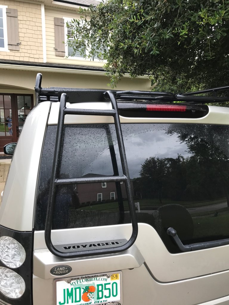

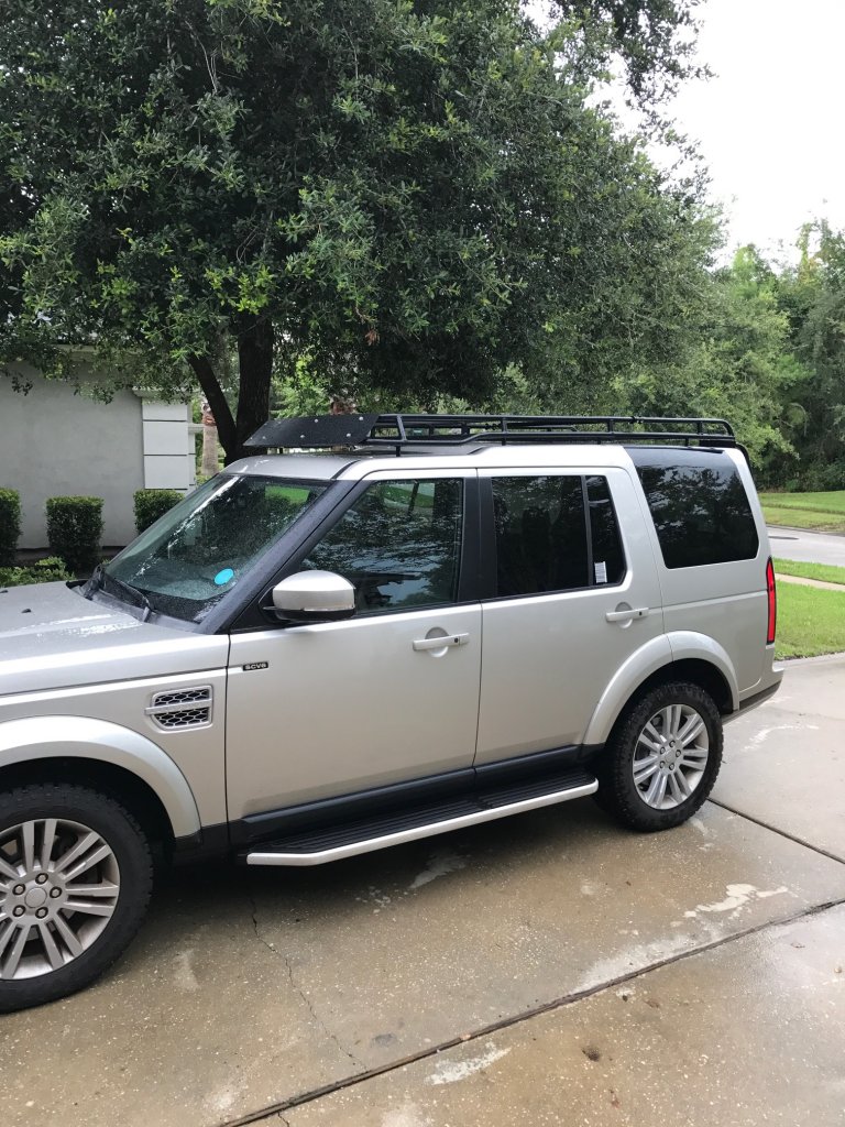

Here are a few shots of the rack and ladder being prep'ed and then the installed kit:

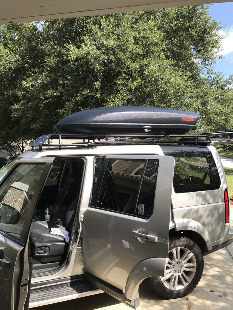

They have a removable cross bar, which will enable me to do a few things without committing to an additional bar at a fixed location: 1) locate it relatively close to the front support bar (about 32") to accommodate my skybox; 2) move to the very back when carrying a boat or other object that requires it to sit up and level to the front; or 3) remove it altogether.

Do you have any pics of your rack with the skybox added? I just got my rack installed and I have a Thule box. I'm wondering if the bar you're talking about would work for me.

That's a nice feature. Be good if it was a quick disconnect clamp or something so you didn't have to get a wrench out every time you moved it, but I like that it covers both needs.
If you put a long boat on will it hit the wind deflector? Looks like the rack would serve my needs as long as I could find some pads for the cross bar and front edge (for SUPs and such).

The wind faring does protrude ever so slightly above the front top rail. However, a small piece of one by wood strip zip tied will likely fix the issue... I have not toted a boat or canoe yet. I will keep you posted once the time comes
