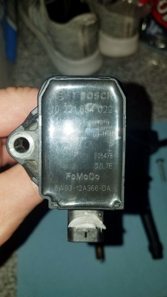

I have a 2010 Rover Sport and recently changed the spark plugs and replaced the NGKs with NGKs at around 140K miles. I noted that the Coils were the original Bosch FoMoCo coils (see pic) and they were working fine and continue to work good. I watched a few YouTube videos and noted that others had tried some less expensive coils and they found them to be inferior in quality with a shorter wire connecting the actual coil to the plug which caused misfires. They ended up going back to the original OEM coils or similar. I noted that the alternator in my Rover is Denso as well, and personally prefer the NGK or Denso plugs. For the coils I think any of the three major brands would work and would just avoid off brand or cheap coils.
