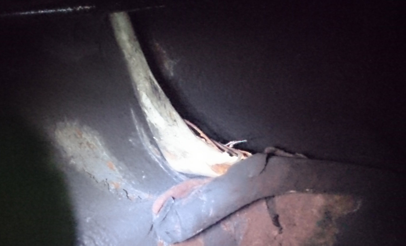

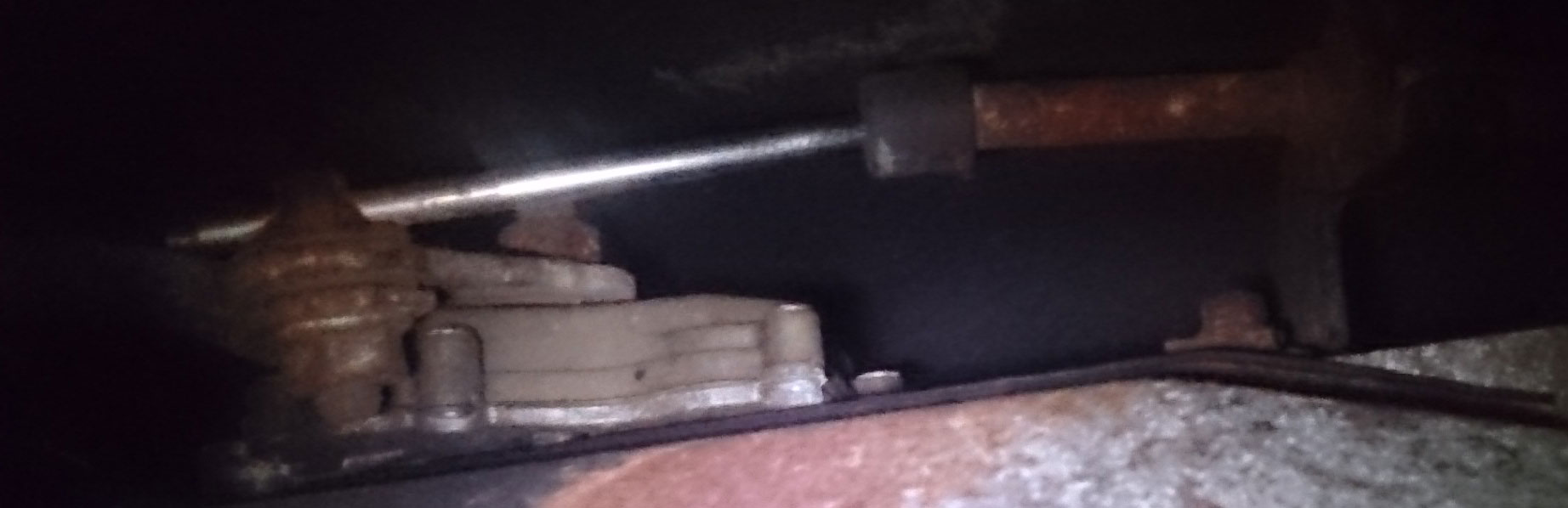

While under the car I took an image of the XYZ switch. Is this normal, but my XYZ rod doesn't look straight. Would this have any affect on not getting the car moving forward?
Also I found a big heavy damaged wire on the passenger side slightly above the transmission, is this my transmission ground?

I replaced the XYZ switch and still no go forward.

Sorry didn't see your post about the wire... Not sure which wire this is, but if it is shorted out it could cause issues if it isn't a ground wire.
