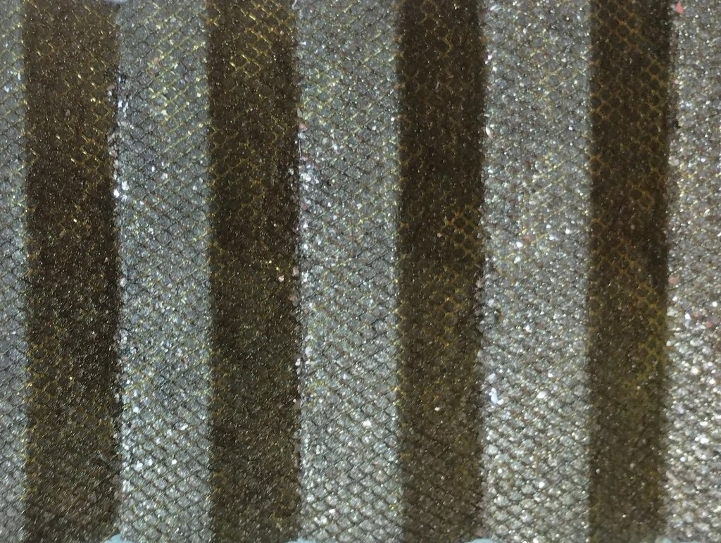

So that's what it sounds like when a rod bearing gives up in a SCV6.
Drained the oil, it looked fine. Cut open the filter and I was getting glitter everywhere.
