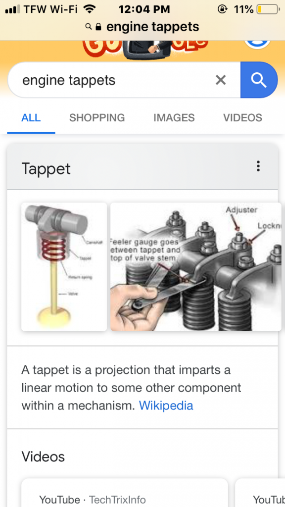

https://www.google.com/search?q=engine+tappets&ie=UTF-8&oe=UTF-8&hl=en-us&client=safari
Engine tappets is always what I’ve known that noise to be. I haven’t broken down a bosche but I have a Windsor and others. https://mechanics.stackexchange.com/questions/27066/what-are-tappets
It is NOT the timing chain. No way. I can’t even begin to know I would never go back to that guy.
I instantly think rapper in this case. I only think rapper but I’m not standing over the engine. I hope this will help you. If that was a Ford I’d be Correct. No doubt.
—Needs a valve adjustment.
