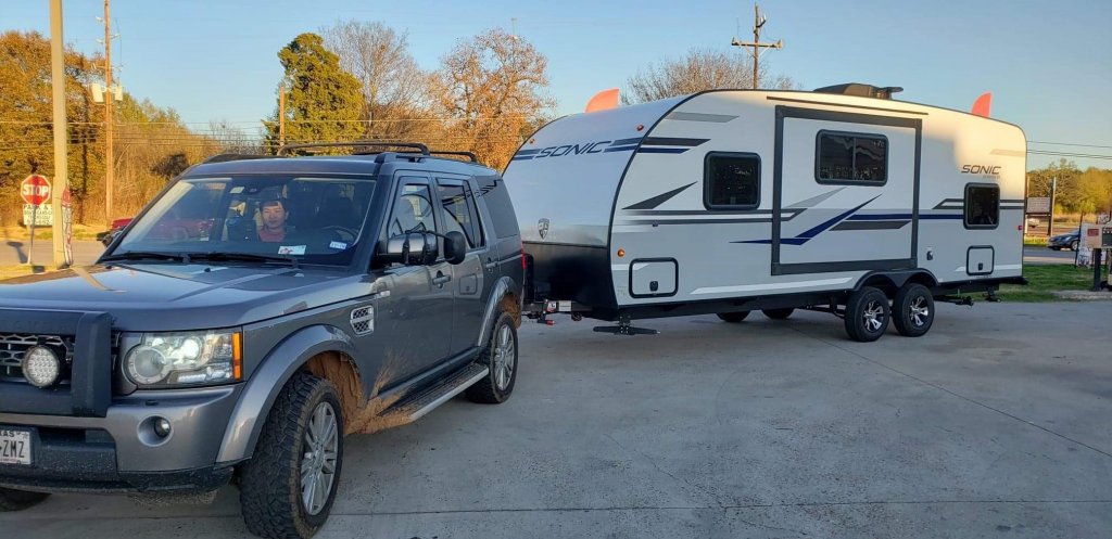

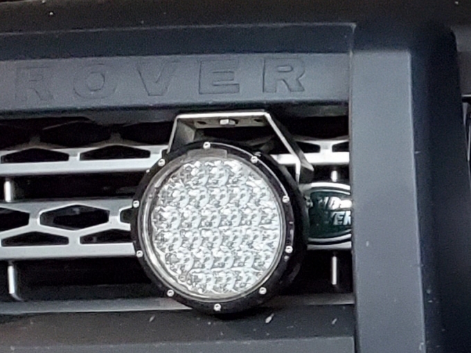

I might be wrong with the OEM lights but I found 10" lights were too big for the soft A Bar. I went with 7" and they fit nicely.
DonC
Oct 3, 2018
99
63
The Woodlands, TX, US
I flipped them over from how the OEMs mount. Drilled a hole and then cut some metal strips to beef up the plastic where it is bolted to. Very solid and when off roading I did not notice any bouncing around of the light.
