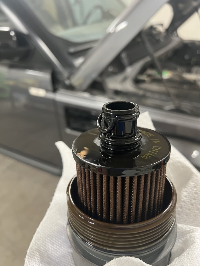

Anyone ever have this happen to them? I always oil the o rings before installing the filter.
There’s a chance I made a mistake on something.
Either way, new filter is in and I grabbed some oil for an analysis.

Can't say I've seen that before, I also apply a small amount of oil before installation; perhaps apply some to the hole on the engine side as well to help ease the installation as you screw the filter in?

Looks like the o-ring is swollen.
Did you use penetrant oil to lube the o-ring?

I just lube it with new engine oil prior to installation.
Never have had this happen before, 12 oil changes and I’ve always run the same filter without a problem.
Either way, when I installed the new filter last night I pulled it out to make sure I didn’t crush the o ring or anything weird like that.
I’ll probably drive it around a few hundred miles and pull the filter to inspect.

Separately, back to your original post: I have never seen that issue with the o-ring. The trouble I have had with these filters is that if I get cheap ones (yes, I bought it on amazon 10 years ago...), then they don't seal well and then you have to over-tighten them so they don't leak (problem with those o-rings I think). But nothing ever came out looking like yours.
Lesson learned (yet again): just get the best filters and stuff you can (if you care).
