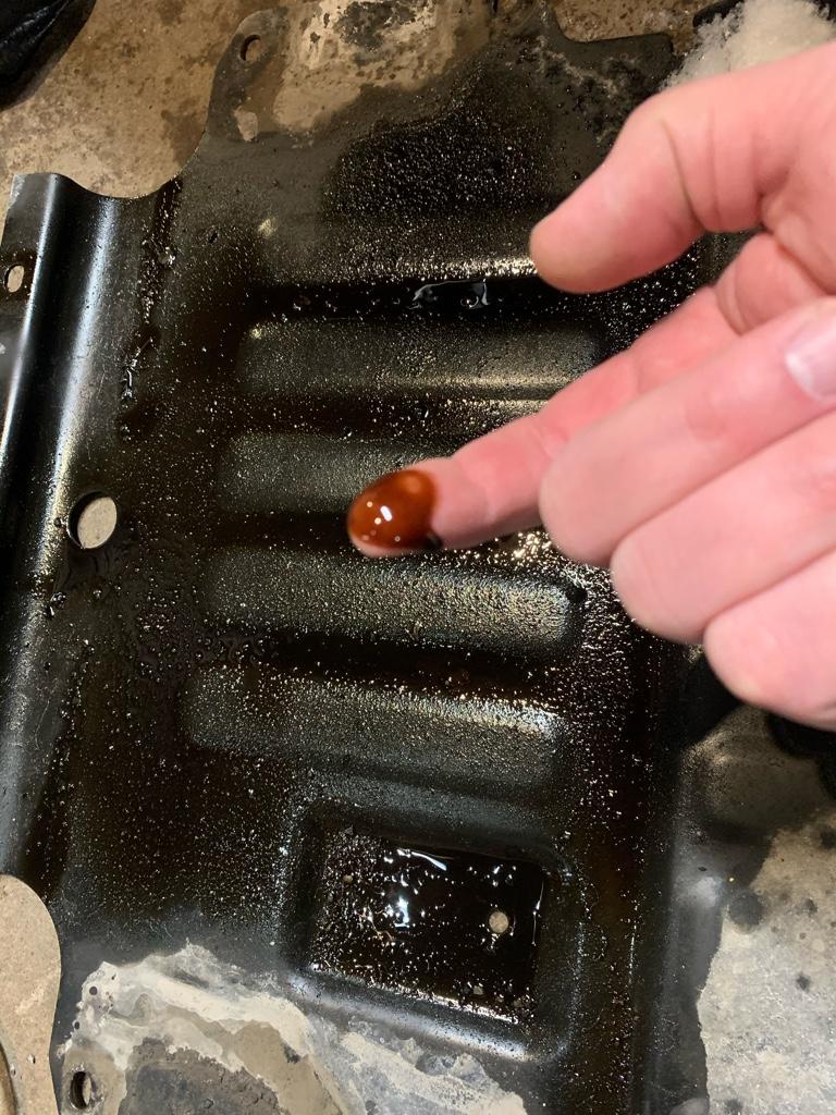

This morning I moved the LR4 so I could snow plow, and I noticed a small spot of something leaking. Immediately I stuck my finger in it and I suspect it to be oil. Pulled in the garage pulled the skidplate off and sure enough I got an issue. I can’t tell where it’s coming from, but I put the heat on in the garage and I will get back out there and start wiping it up. I looked underneath when I bought it and everything looked dry, no records of any leaks in the service history I got from the Indy. Going to need some help with this one.

thats a "nice" leak you have there. defintly appears to be oil. since its a good mount, it shouldn't be hard to locate the source.
take a flashlight and look up as far as you can, for any signs of oil/wetness/sticky dirt accumulation.

It does seem kind of red, but doesn’t have that transmission fluid smell. My sniffer doesn’t work very well after Covid-19....

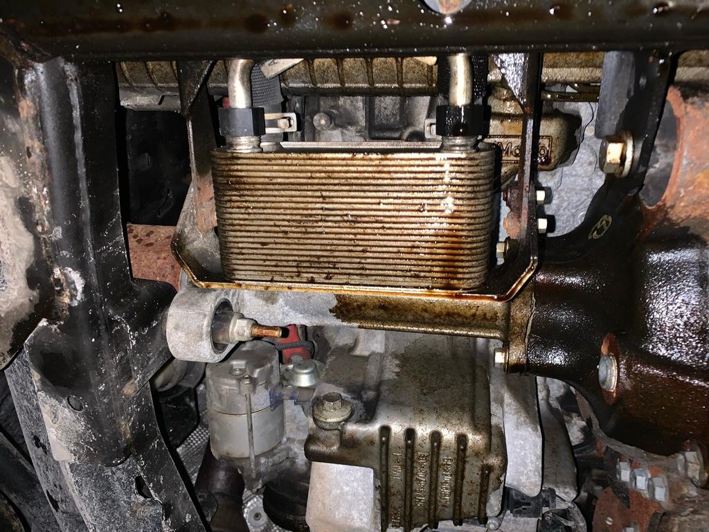

That TSB is the issue I was referring to, although I think the problem still existed in later models. Another TSB on the same problem was issued in 2017 that extended to the later model years.
Transmission cooler is on the bottom of the engine compartment - towards the front. If you look down past the belts, you can see the oil cooler lines. Better view from the bottom if you remove that front skid plate (as in the picture in the first post of this thread). The TSB that DaytonaRS7 posted has some good illustrations.

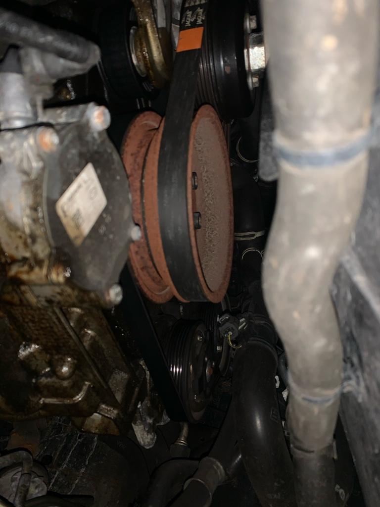

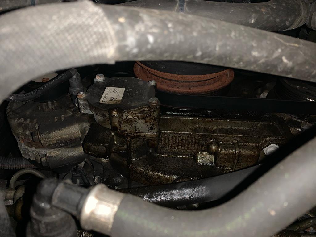

Well, I just got that sick to my stomach feeling. Pulled the radiator skid plate, and can see that the oil leak goes up pretty far. Haven’t had much time to get involved yet today. Later tonight I will look from the top down, maybe valve cover, was that an issue with these? I just bought this thing, could I have really missed this when looking it over?
