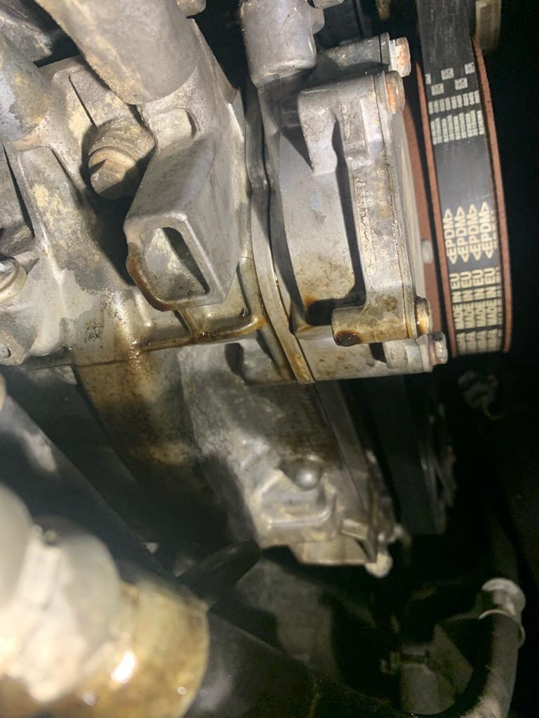

I’ve been cleaning up as much of the oil as I can to pinpoint any other leaks. Most of the oil is located around the vacuum pump, and with the fan blowing it makes it difficult to rule out as one of my issues.

I had everything cleaned and wiped off last night. Went for a drive today, maybe 20 miles, and checked it. The vacuum pump looks a little suspicious, think I might have a leak there as well.

100% vacuum pump leaking in that photo. easy fix.
that doesnt mean its the only culprit though....
I think there are more issues. I contacted the seller today, it was a small dealership, haven’t heard back, curious how that will turn out.
