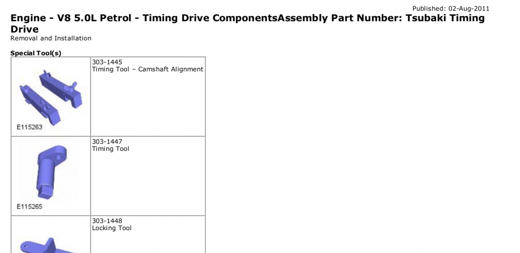

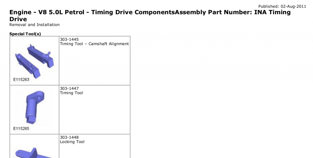

When I saw the two different procedures in the shop manual, I had to investigate. The luck I'm having with this truck already that would be icing on the cake to not have the INA Chain.... Here is some info that was given to me by someone that has tackled this job already:
Jaguar changed the pitch on the cam sprocket teeth early on (from 6.35mm to 8.0mm) when they brought the 3.0 and 5.0 engines to market. Unless you have a very early 3.0 or 5.0 Jaguar you will have the 8.0mm pitch. Every Land Rover with the 5.0 V8 has the INA 8.0mm pitch timing chain setup as it is more robust. Both timing chain setups are interchangeable, and if you go to buy parts today for a vehicle that had the Tsubaki 6.35 parts (cam sprockets, crank sprocket and chains) you'd be wise to upgrade to the beefier setup.
