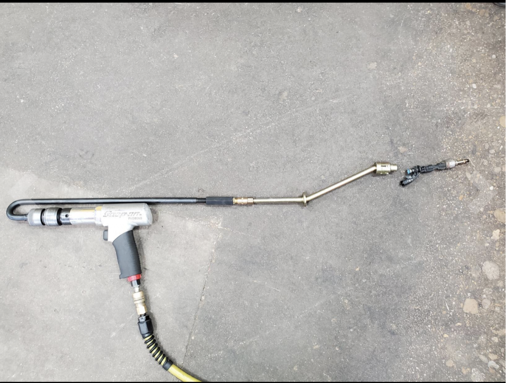

Check out this pic of the "Texas Twister"..... that's one way to get the injectors out.
