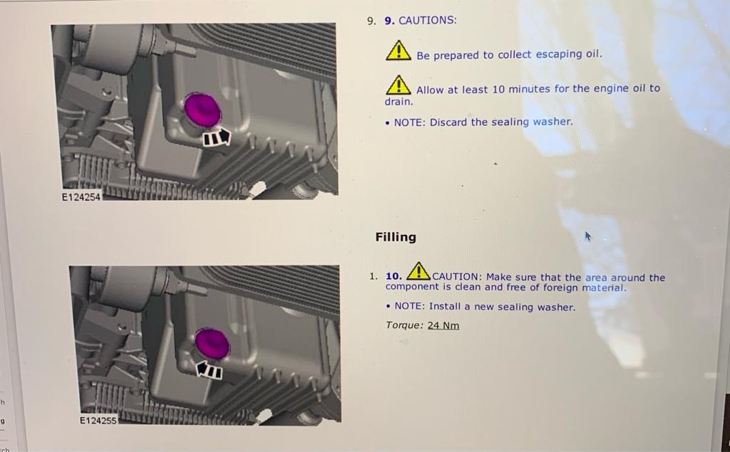

In the shop manual it just says discard sealing washer and install new sealing washer. No mention of a part number.

Not sure what the gasket is. I would imagine it could be a brass crush washer. You would probably be able to go to your local hardware store to find a substitute, but the issue is you could only do it with the gasket in your hand and your car empty of oil.
Worst case is you reuse the gasket. I've reused plenty of gaskets on oil drain plugs in my time, and have never had an issue.

I just ordered one from Atlantic British. Figure it’s probably best to have one in my hand before I do it, especially if it’s a rubber seal, and nobody has ever changed the oil via the drain plug.

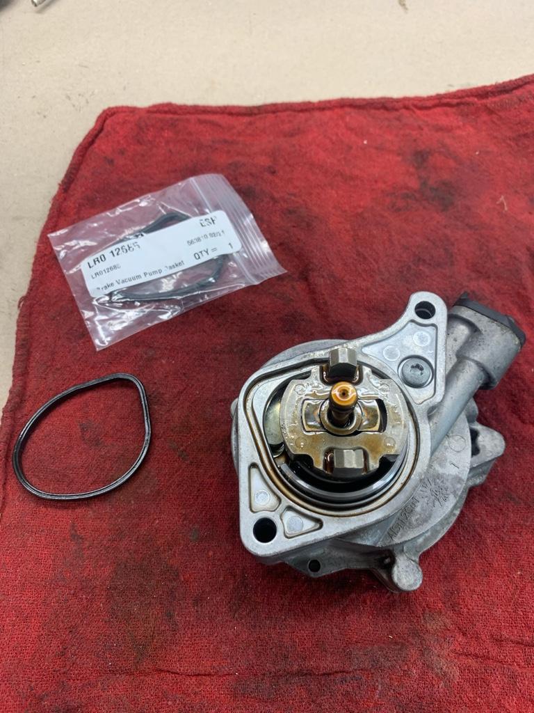

On another note I just changed the vacuum pump seal, super easy. Took me maybe 10-15 minutes. The old seal didn’t seem too bad, but I did notice it was much harder than the new one. Fingers crossed that I fixed one leak.

It is a rubber seal built into the oil drain plug, not replaceable IIRC. I re-use it, no issues so far.
I'd recommend some sort of plate or baffle to direct the oil stream coming out of the pan, it makes an incredible mess otherwise. Last time, I tried a 1-inch 90° PVC pipe elbow, put in place as soon as I pulled the plug. Reduced the mess 90%.

I will third the re using the drain plug and not having any issues and second the notion of having some sort of system for oil drain management as I made a huge mess the first time.
