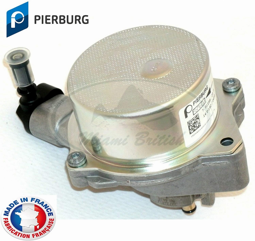

100% vacuum pump leaking in that photo. easy fix.
that doesnt mean its the only culprit though....
Remember that means replacing the entire vacuum pump, with the newer version, which may require different length bolts.
I tried unsuccessfully to apply a bead of sealant around the outside of the old vac pump cover. It reduced the leak 90% but the last 10% is driving me nuts. I'm going to have to replace the blasted thing. *sigh*
If the vac pump can be R&R'd without draining the oil pan, that is fantastic. The FSM implies you must drain the oil, or you'll get an oil bath. Would be fabulous if that's wrong.
I had my LR4 parked on a (very) slight incline when i replaced my vacuum pump. No oil spilled out.
I don't see why you cant just replace the gasket? that said, I replaced my entire pump.
It appears as though his pump is the newer/revised one. longer bolts shouldn't be needed.

The old style pump leaks from the front cover, not from the seal at the rear against the block. Have to replace the entire pump to cure a leaking old pump.
HOWEVER, you are correct! The pump in the photo is the new style with more bolts holding the cover on, with an improved design. My bad, I missed that. I'm also not convinced the leak in the photo is actually from the pump though; it may be from elsewhere and the oil is moving around the pump area.
The old design is shown below, stamped steel cover with only 2 screws... if replacing the old one, different bolts are needed for the new-style pump:
