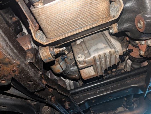

2012 V8 I have discovered a leak
Of experts, an opinion do I seek
I am certain by smell it is gear oil
But from where it doth come, do I toil
It drips from front diff cylinder mount
A half dollar size daily do I count
Nothing has gear oil above
Hence this theory at present love
Is there a seal where axle shaft meets cylinder
Here I suspect my leak as it were
But I am a novice in all things "4"
So those better than I, share your lore

Since the oil leak is on the right side of the vehicle. The seal for front tube coming off the diff, is leaking.

Thanks all ...I was reading the service manual this morning and replacing seal seems pretty involved with a few special tools. I will monitor and prioritize against leaking fuel tank seal, random suspension codes and this front diff leak.

Check the fluid level in the diff! You may be surprised how much you're losing as you go down the road.
How much is a new diff anyways...
