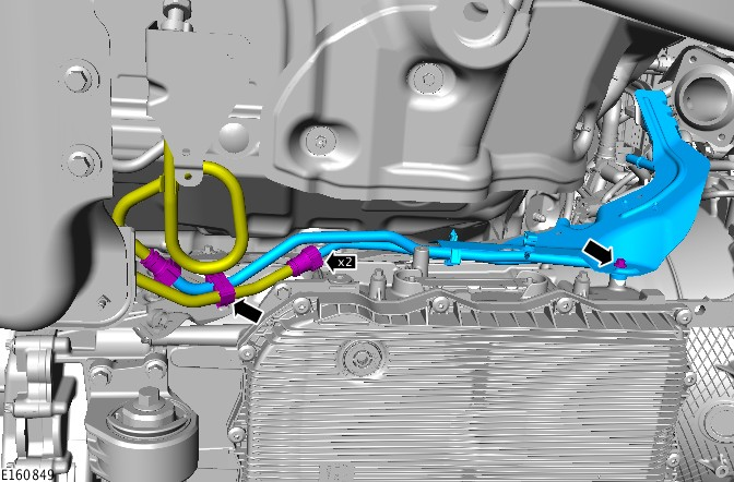

Only "shield" is the bracket for the fuel lines.

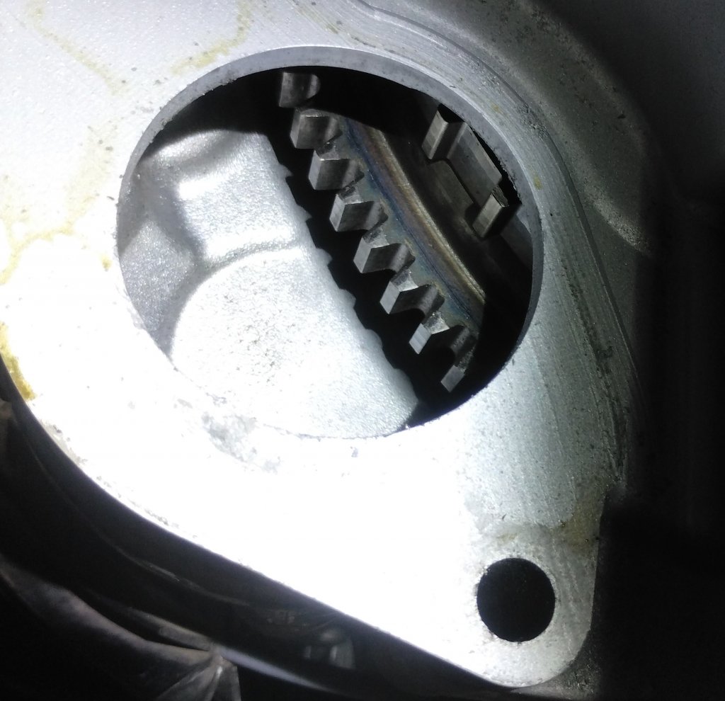

Think I found the source of the noise, starter gear is clashing with the flywheel. A couple of washers might be a short term fix. Thinking I'll get some gasket material and hope it is thick enough.

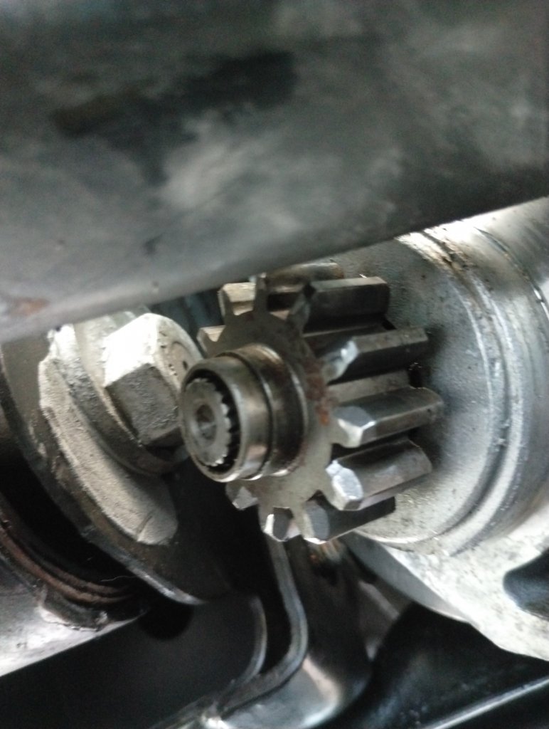

Starter bendix may be binding. Not fully retracting, keeping the starter drive gear out further than it should be.

Flywheel and starter can really only go in one way each. I noticed considerable overlap between the starter and the flywheel on the first motor. Didn't think it was right, but thought once the starter was energized once it might retract a bit more. Forgot to address it with the second motor, but I remember it being not as bad.
Probably should get a new starter, but they're out of stock on rock auto and O'Reilly's. Next time I order from Atlantic I'll get one. My temporary (permanent) fix was to grind the teeth back about an 1/8th and put a fresh chamfer on the leading edge.
