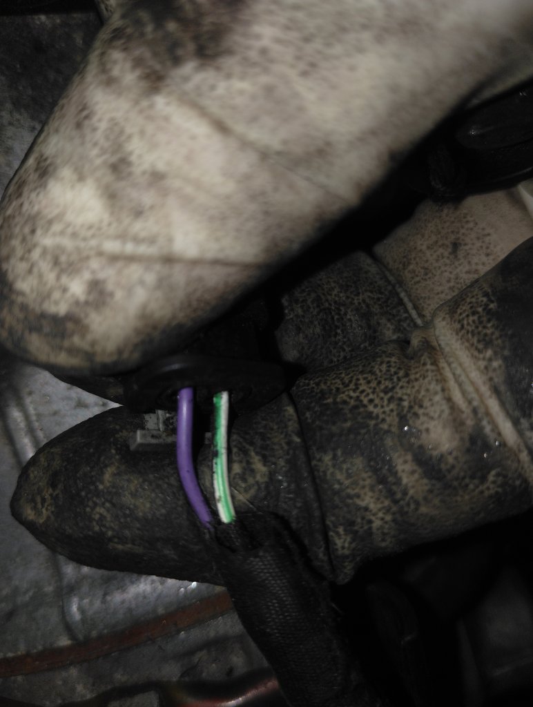

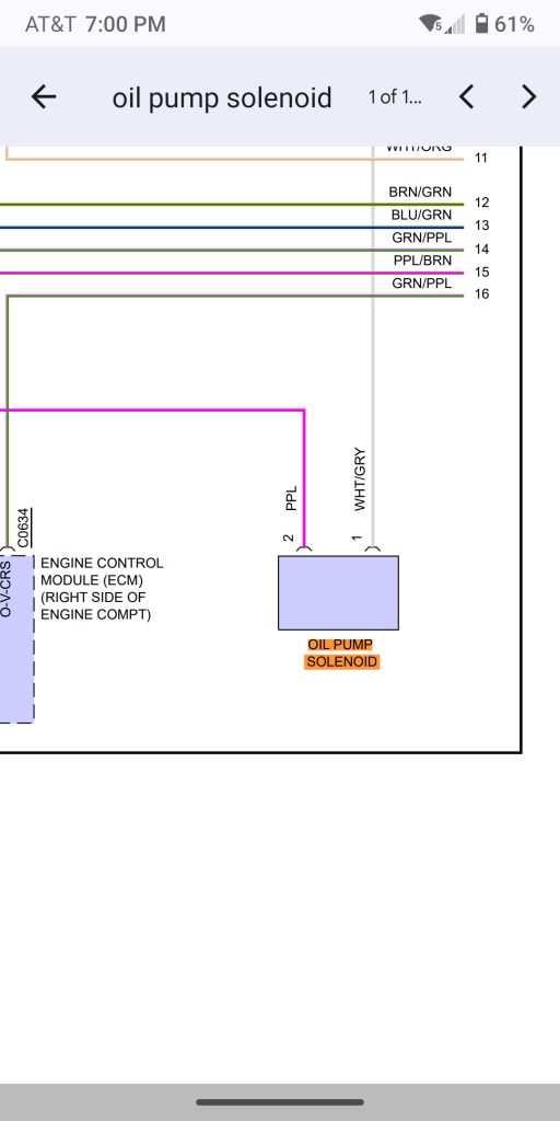

As I continued on to other things wiring related I'm annoyed and stumped. The only connector in the vicinity of the oil pump solenoid is purple and white/green. My copy of the manual says purple and white/gray. The wiring leads towards the back bottom and joins up with the oil level sensor and CPS before going up the driver's side of the engine.

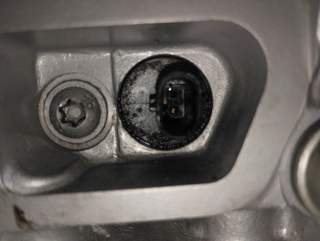

To make it all just a little bit worse, it looks like one of the pins for the oil pump solenoid is pushed in or broken. Going to have to investigate further tomorrow.

Post your VIN #.
I check the Land Rover manual for the
wiring orientation.
