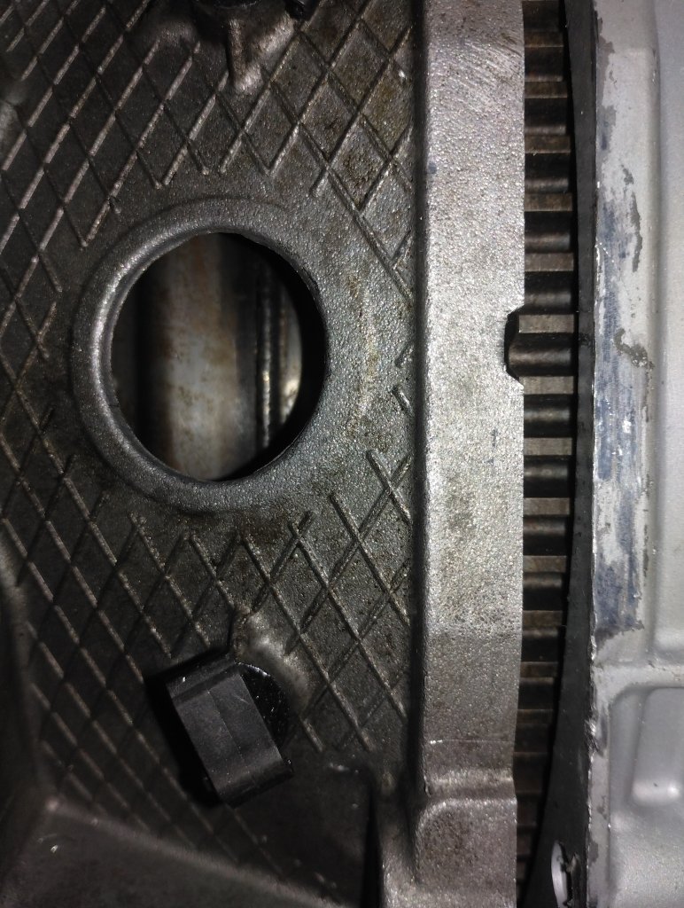

I get this close and it doesn't seem to want to go any farther. Does the torque converter weld bead appear to be in about the right spot relative to the inspection hole? Really don't want to pull the engine back out just to visually confirm that the torque converter is fully seated.

Torque convertor needs to be further back.
Take a screwdriver and turn the torque convertor, through that hole.
Hopefully the torque convertor will pop into the the transmission front pump.

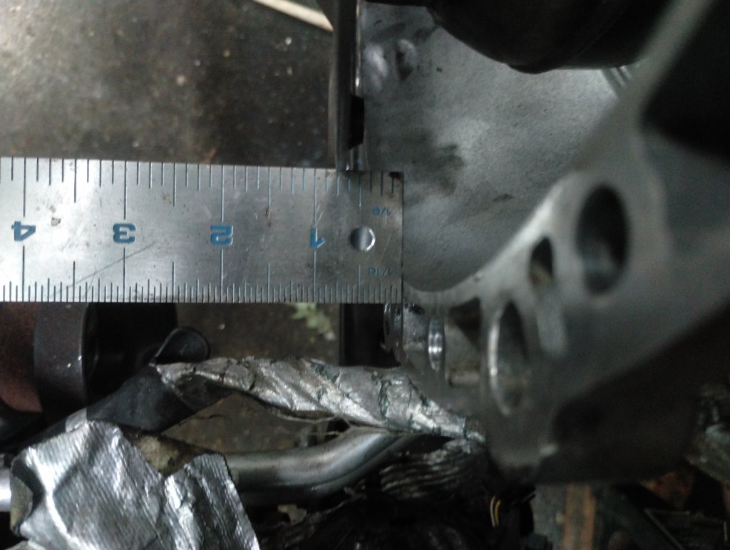

Engine is back out. Is there something dumb I'm missing about getting the torque converter to seat all the way? Just keep playing with it?

Pull the converter out.
Line up the notches in the converter with the two lugs in the transmission.
While supporting the converter as level as possible.
Insert into transmission while gently rotating a couple degrees.
You will hear a solid clunk when the converter seats into the pump.
