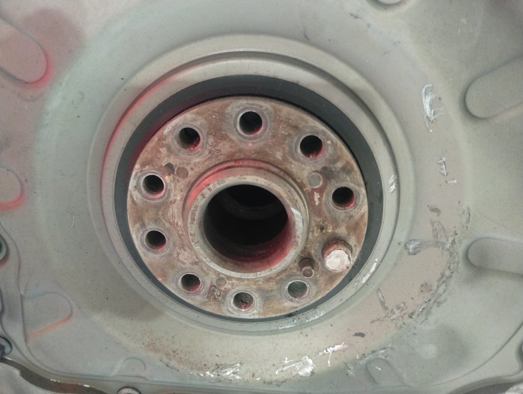

Old motor is in the shipping crate, new motor is on the stand. Those flywheel bolts were absolutely bathed in red loctite, big 1/2" impact really had to work. I went 9 for 10 though. One of them rounded over and I tried every trick short of welding a nut on. I resorted to just gently grinding down until it was free.

You applied heat first right?

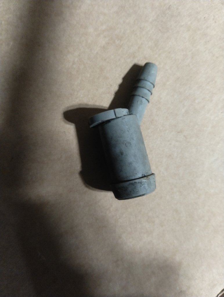

Not sure when I broke this, but it goes on the end of the short hose coming out of the throttle body. The barb that goes into that hose broke, fat side connects to LR 014567, barb coming off at an angle connects to nothing if I remember right. What part is this?
