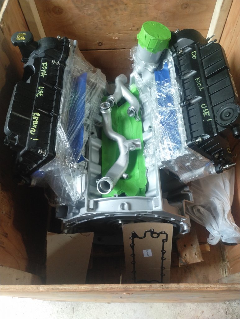

It has arrived. Time to order just about every sensor I can. Last thing I want to do is have to remove the supercharger to replace something like the knock sensor. Also started pulling up torque specs and am surprised at some of them. Exhaust manifold, 18Nm. Torque converter, 63Nm.
1,403
It says do not use lol. Yes the suction tube gets squiggly near the bottom. Not sure trimmer line would work.

Yeah, long block doesn't include valve covers. Part of why I waited to order parts until it arrived.
Took some digging, but found the part number for the flex plate to crank bolts, LR096833. Any know what the torque converter bolts part number is?

Are those coolant pipes one-piece and metal? Where did you get them?
