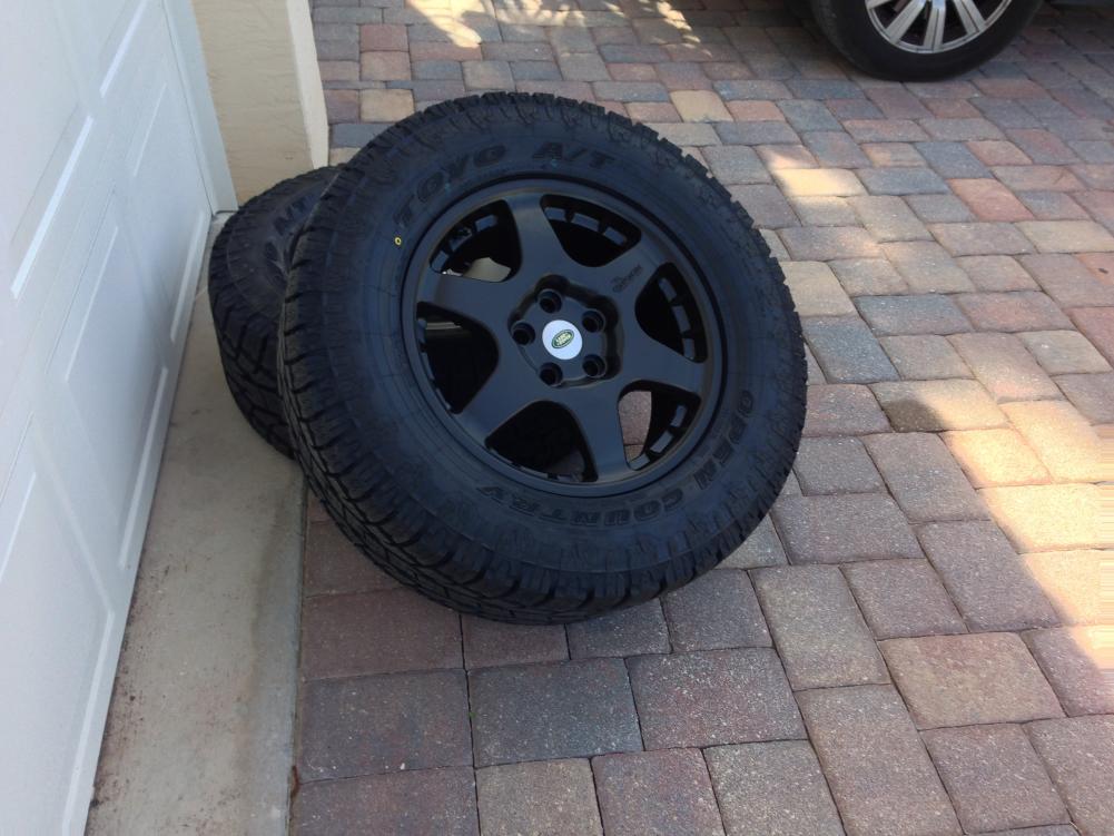

I just picked up the tires yesterday, but it was too late to get an alignment. I should know by the end of the week.

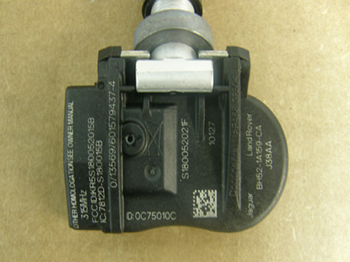

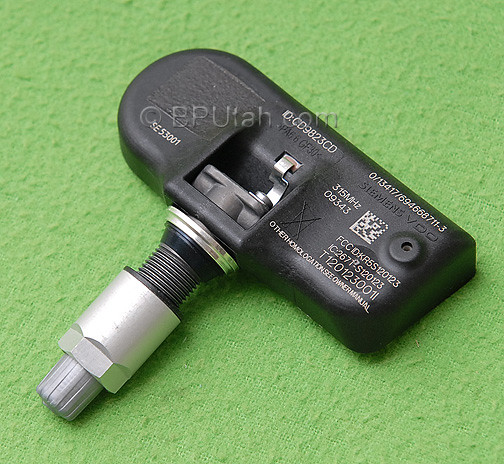

for the TPMS, the LR4 use different one compare to the LR3...
I got mine for $34....
The Jaguar Part # is C2D15551 & the Land Rover Part # is LR021936.
you need to get one look like this
NOT this

That is definitely my issue. I purchased the bottom ones. Ill correct the next time I buy tires in 6-8 months ;)

sorry if im toooo late to response...
I bought a oem rim to fit a full size spare...
NOT this
