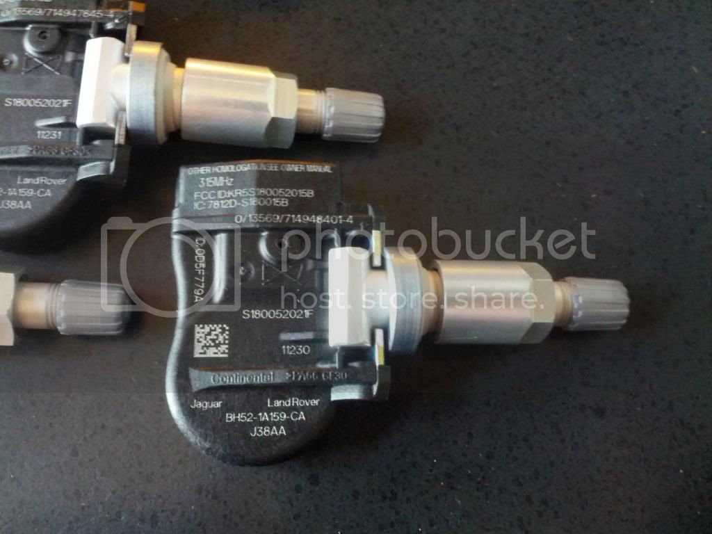

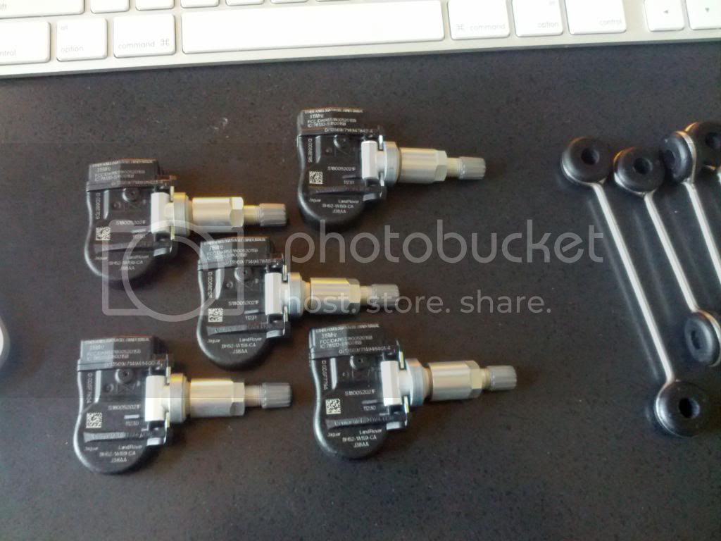

I bought these: http://www.tpmsdirect.com/Land_Rover_LR4_TPMS_Sensor_p/1055-20.htm
and I got the real deal: Jag/Land Rover part! Note, its the continental part.

Same here, mine just arrived yesterday from TPMS Direct and they are the real Land Rover sensors. A set of used 2011 wheels should arrive today and Nokian Hakka R2 SUV tires are on order as well.
