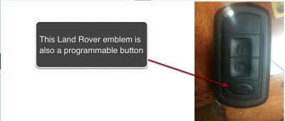

Re-reading the LR3 owner's manual, I learned that the key fob transmitter has a third function button: the Land Rover emblem at the bottom can be programmed to perform different functions. The owner's manual explains how to set it up to act as a panic button, sounding the alarm system, initiating the headlamp courtesy delay, or even raising or lowering the air suspension.
I thought the remote up and down air suspension would be handy so I set that up pretty easily. The user manual says you have to turn on the hazard warning lamps and close the doors. Unfortunately it would only work when the hazard flashers were flashing, which for me ruins the usefulness.
Anyway, the Land Rover emblem button on my second key fob remote operated a fourth function: it unlocked the rear hatch glass window alone. I think that could be kind of handy.
Unfortunately I re-programmed that emblem button for air suspension and now I want to get the rear hatch window control back. I've not found this in the owner's manual. Does anyone know how to do this?

If it's the same programming procedure as my 2006 Sport, you press the Land Rover button on the remote and, while keeping it pressed, you operate the rear hatch window switch. Button should then become programmed to release the hatch. If that doesn't work, try the hatch release button on the center console (again while holding the Land Rover button on the remote pressed.)

Thanks, Umberto. I was able to reprogram the Land Rover emblem button to unlock the rear glass hatch. Don't know if you need to begin by turning on the ignition, but I did. I put the key in the ignition, turned it to Accessory, immediately removed the key, walked around to the back of the vehicle and while holding down the Land Rover emblem button I opened the rear glass hatch. There was no feedback, but after that the key fob emblem button unlocks the rear hatch.
