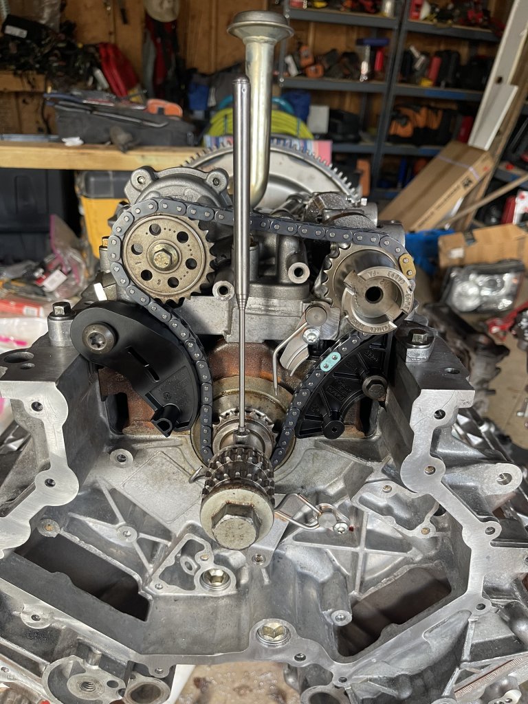

I went ahead and installed the oil pump and pick up tubes. Then installed the new drive chain, timed to the crank tick mark and fuel pump cam mark.

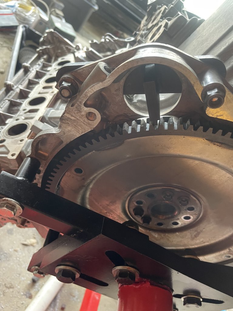

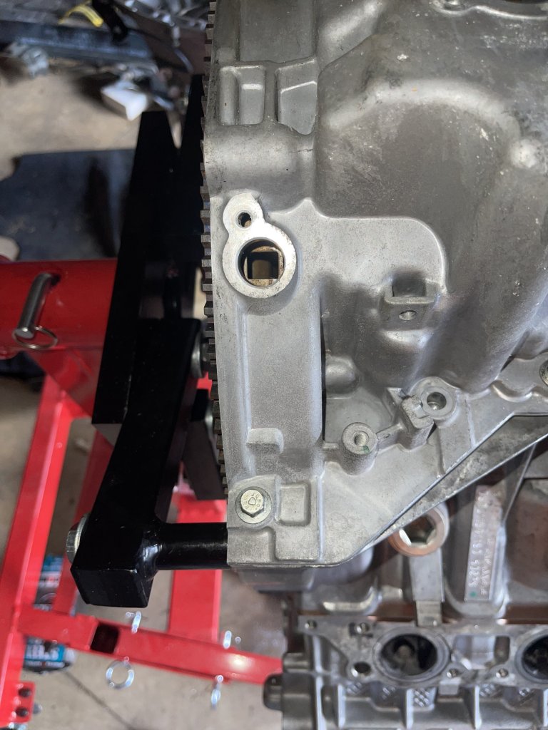

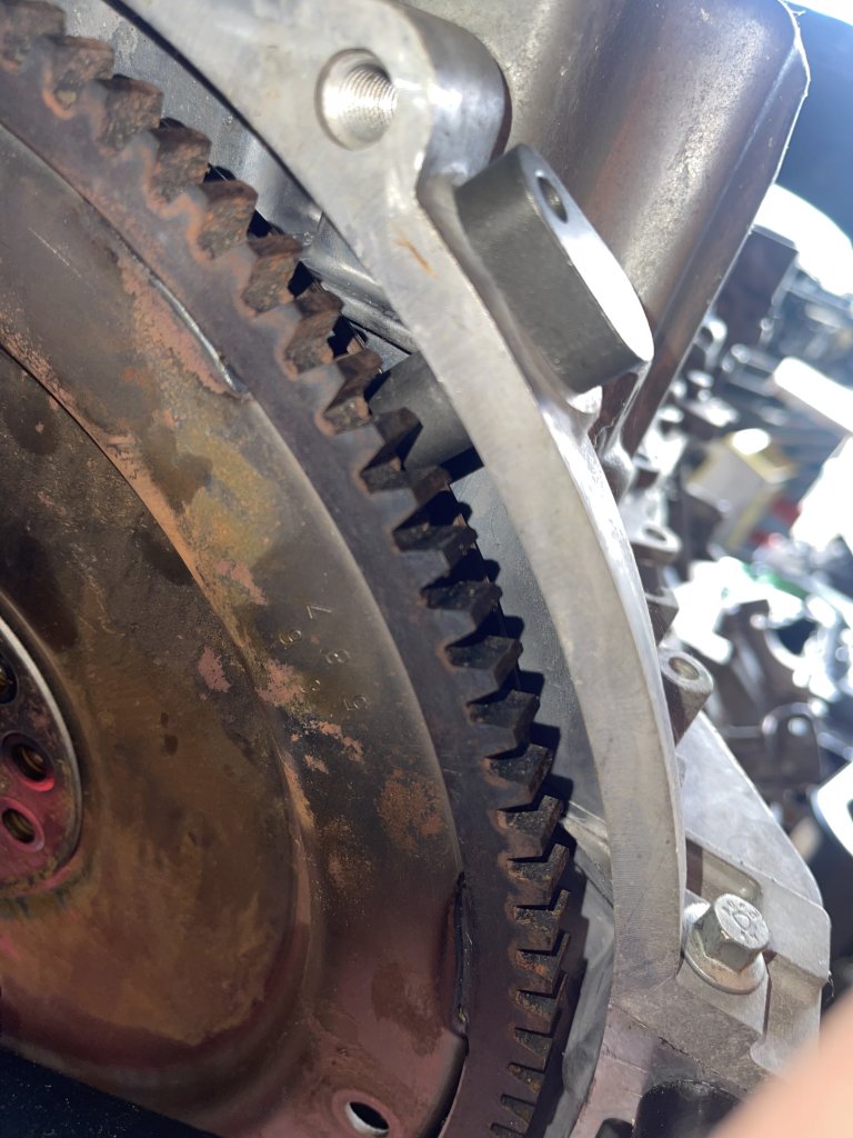

For those of you wondering why I have a magnet on the crank, it's simple, I "eyeballed" the crank key at the 6 o'clock position, but was able to use this to get a better alignment using the baffle plate center bolts. The sad part is that I was still a little off when trying to install the crank position sensor lock...which is SOOOOOOOO much easier with the engine out!!!! That particular lock is so precise, it won't fit even if you're a degreee or two off....which makes sense cause then none of the other timing marks would line up in the front.
I took a couple pics of the locks in place from some better angles than usual, plus I tried to show them from the inside as well.

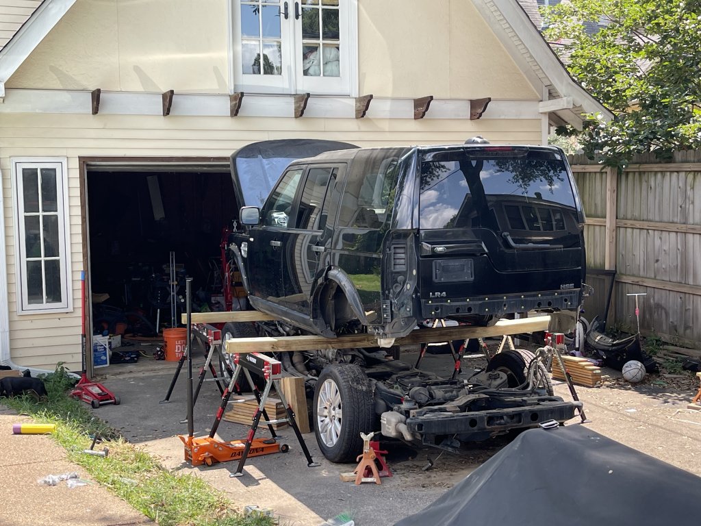

I haven't made much more progress because I've been working on separating the body for the last couple of days, but should have everything off and ready to swap this afternoon!

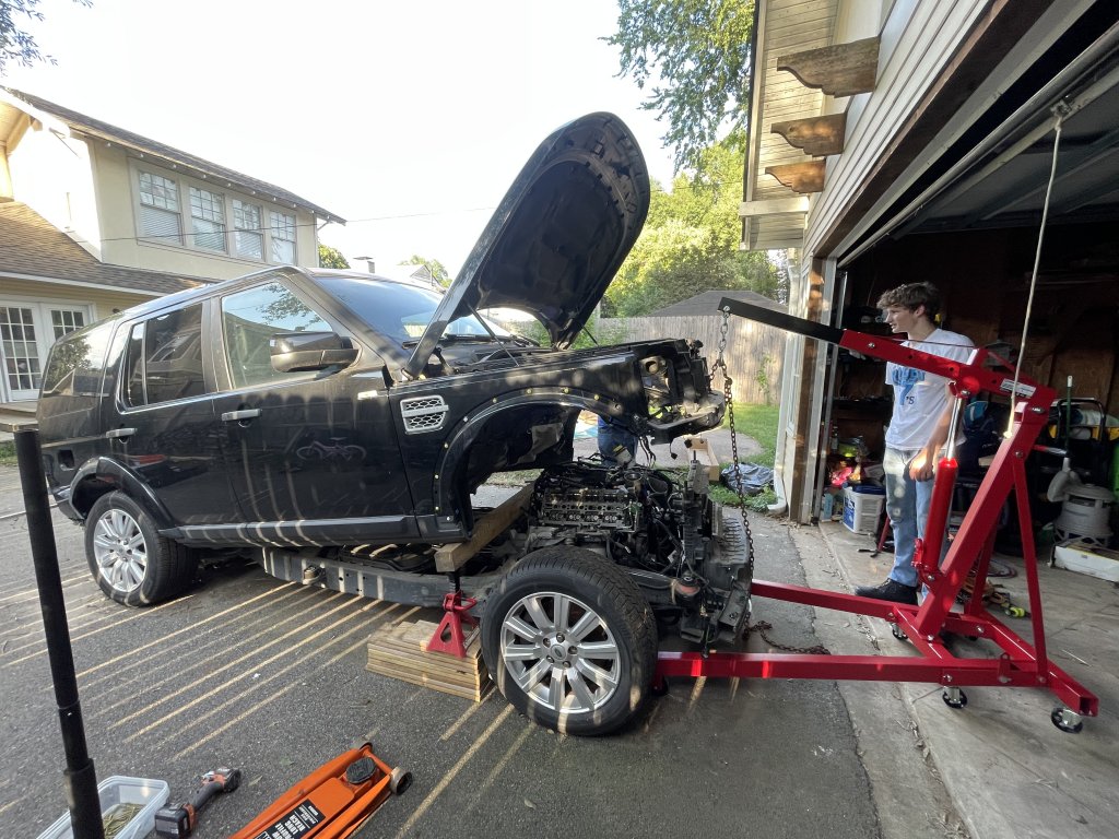

Rent a telehandler for the day you want to put the body back on?
Ok, I give, what's a telehandler?
While I think I cracked the lifting code over the course of a couple of the lift, I'm always open to suggestions and ways to make it easier.

Gotcha, I may go see if the local rental depot has one. That said, a cherry picker on the front and a floor jack with some blocks in the rear and she came right up....course it took me a few attempts to figure out where the best jack points were.
